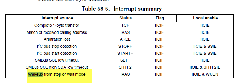

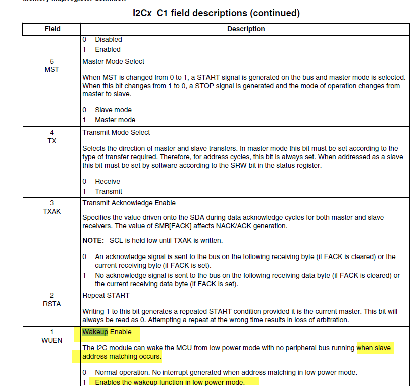

kerryzhou
Hi Eugene Hiihtaja,
  This slave I2C wake up is the slave address matching wakeup:
LLS3 can't be waked by the I2C module, it need to use the LLWU module to wake LLS3.
Kerry
