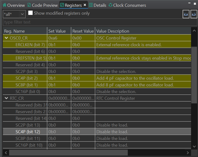

I have a 32,768kHz +/-20ppm 12pF load cap crystal in my two custom boards. In both PCB the RTC drifts aproximatelly +120s/week. That yields +200ppm if I am not mistaken, which is quite high.
SC8P and SC4P fields of the OSC_CR register are enable using the Clocks Config tool on MCUXpresso.
I noticed RTC_CR is disable. Is that correct?
I understand that enabling SC8P and SC4P the oscillator block will add 24pF on EXTAL and 24pF on XTAL pins, correct? Besides, the crystal is 1mm far from the XTAL/EXTAL pins of the MCU (see next).
AndreVB_1-1660762020044.pngAndreVB_1-1660762020044.png below and to the right of the crystal is GND, above is RESET pin.
PCB is at room temperature all the time. That said, if the OSC_CR setup is correct, any idea what could be causing such high drift?

Thank you for your reply. The AN describes many potential problems but for Kinetics KL devices, as log as the low frequency crystal is close to the I/Os, the load capacitance is correct, and the crystal far from other noisy signals, it seems there is not much to do about it. I was also very careful in soldering the crystal.
The drift is very high. I have used a RTL code example from KL27 as starting point.
If you have any clue of what could cause the drift, please share.

I must admit that I can't think of another clue that could cause the drift that isn't mentioned in the aforementioned application note and the recommendations in section 28.6 External Crystal / Resonator Connections of the reference manual.
Now, if you can no longer optimize the oscillator design, you could try to increase reliability through software, for more information about this, please refer to section 32.4.3 Compensation of the reference manual. Also application note AN4949 can serve as a reference.
