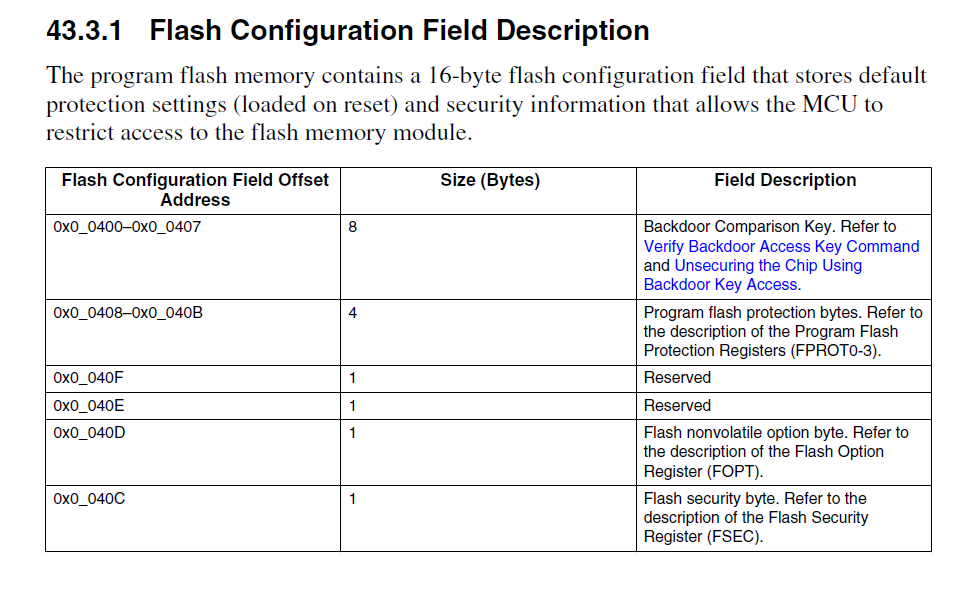

  But from your linker file,your application code relocate have the problems.
As you know, flash address 0X400 is the flash configuration field, this is the very important area to the kinetis chip.
I think you can relocate your application code to flash address 0x1000, besides, you must make sure your bootloader code size is smaller than 0x1000.

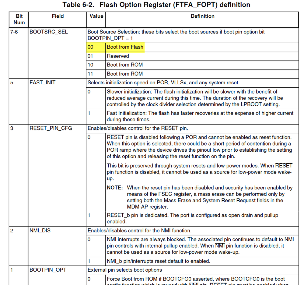

   Please also check the FOPT data, let the MCU boot from the flash directly, not the ROM bootloader, 0x40d, configure bit7-6 to 00:
Please try again.
Any updated information, please let me know!
Kerry
3,757 Views
yonhona
Hi, thanks!
this was the problem.
