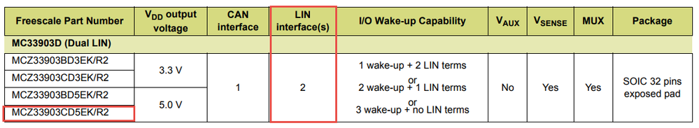

Does the FRDM kea128 demo board(Red board ,2015 ) support LIN interface, The schematic have LIN Interface, but the datasheet about MCZ33903 have not LIN interface, Can you clarify it. thanks

FRDM-KEAZ128Q80 board supports LIN interface.
The board is using MCZ33903CD5EK as LIN PHY chip, which with below features:
Wish it helps.
