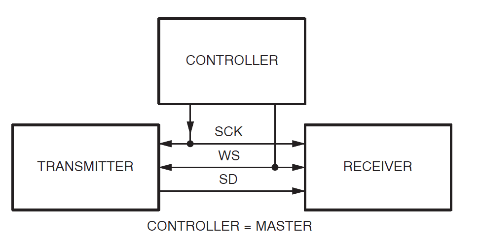

lancebantoto
Hi Ma Hui,
I am trying to use the MCU as the I2S master as shown in the diagram above. Hope it helps.
