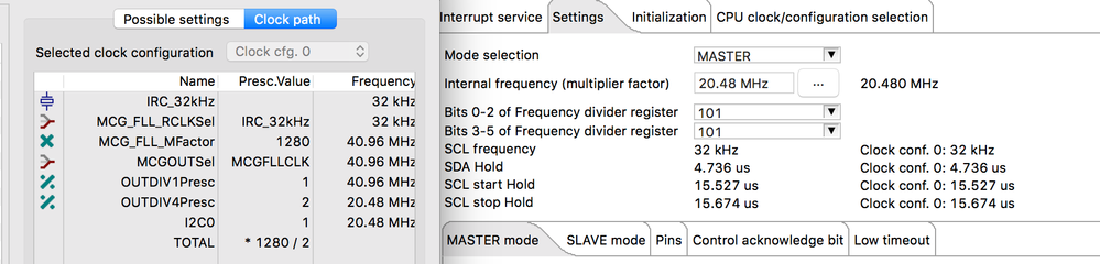

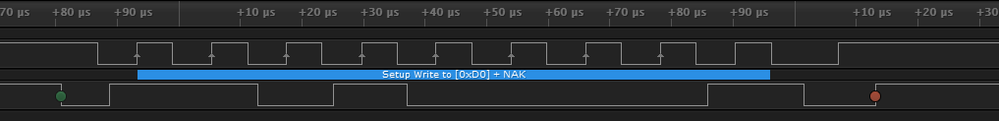

On an MKL16 (128 flash version) I am seeing a missing repeat start bug when using the I2C_LDD Processor Expert component. I tried many clock path options including many that set the final I2C0 prescaler to 0 and 1, and the issue persists.

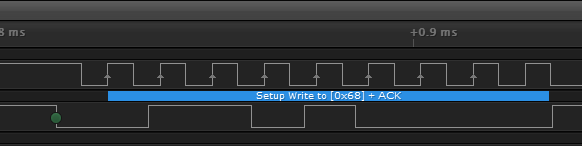

This should be a write to the i2c address 0x68. Here's an example of what I expect (this was generated using a different device/master)
Edit: A blank project with only an I2C component seems to work fine. The issue must be with the use of I2C0 at the same time as some other component.
Edit: False alarm: a blank PE project with only an I2C component shows the same issue.
Edit: Tried operating at 3.3v instead of 1.8v, same result. I cannot find any working configuration for i2c.

Hi Jacob Jennings,
      If you want to get the 0X68 in the I2C bus, please modify the code in your project main.c:
    CI2C1_SelectSlaveDevice(CI2C1_DeviceData, LDD_I2C_ADDRTYPE_7BITS, 0x68);
  to
  CI2C1_SelectSlaveDevice(CI2C1_DeviceData, LDD_I2C_ADDRTYPE_7BITS, (0x68>>1));
Because you choose the 7bits address, then the address data which you send will choose the lower 7bits and <<1 used as the data send in the I2C bus line.
Please modify the code, and try again.

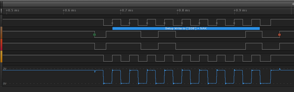

Here's an example project and the result I see in logic analyzer:

Of course! I love a simple solution. Thank you kerryzhou​

I did confirm that this produced the correct result from the logic analyzer.
