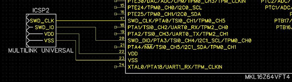

Hi All,

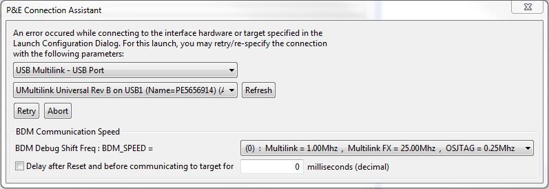

I'm having a problem with the debugging a KL16 at CW 10.6 through P&E Micro Multilink Universal.
The target is on my custom board, and the program circuit connects the SWD_IO and SWD_CLK direct to the correspondent pins at MCU. The board has your own power supply.

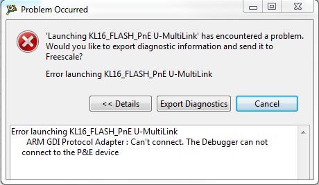

So, when I try to connect to the target the error message below are shown 2 times:
After this, the below message  are shown:
After a lot of tries I've just clicked at Abort, so I get the message:
The project with this error are attached.
Someone can help?

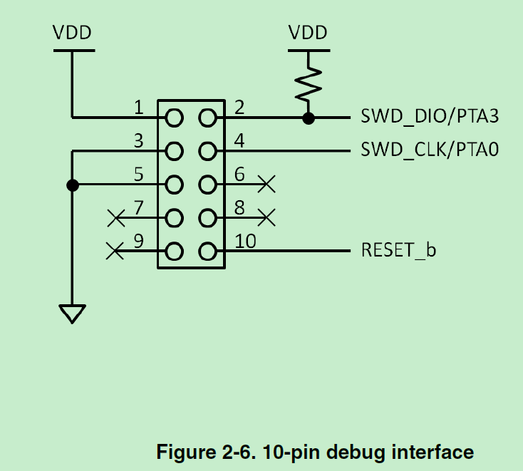

Hui_Ma
HI,
Please try Freescale recommend SWD debug interface for KL series product.
Customer also can download FRDM-KL26Z board schematics from below link as a reference.
http://cache.freescale.com/files/soft_dev_tools/hardware_tools/schematics/FRDM-KL26Z_SCH_REV_B.pdf
Wish it helps.
best regards
Ma Hui

Hui_Ma
Sorry for the delay reply.
I checked P&E Multilink Universal with below SWD debugger interface setting for Kinetis L series product.
So, please try to connect /RESET pin with KL16's PTA20 pin as FRDM-KL26Z board shows.
Wish it helps.
Ma Hui

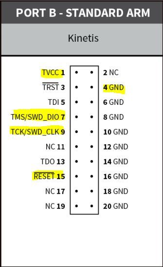

wendersonolivei
Hi Ma,
Maybe I wasn't clear. I already done this, the RESET pin is connected to PTA20.
I haven't the PORT G - Mini cable, so I'm using the PORT B with the highlights pins:
It's correct?
9,177 Views
Hui_Ma
From your attached picture, it should be correct.
In general, the Kinetis L boards is using Mini-10 interface, such as PORT G interface for Kinetis L series product board.
I think you select to use PORT B also should work. While, we don't have checked with Kinetis L board yet.

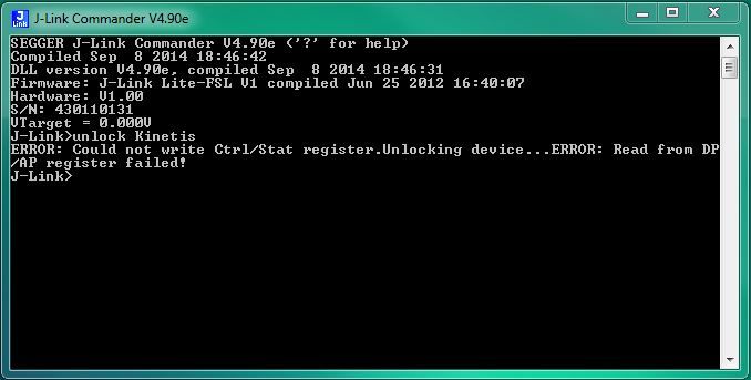

wendersonolivei
Hi Ma,
I have a 10Kohm pull-up attached to RESET pin. His voltage is about 3V.
I've tried to unlock Kinetis at J-link commander. But, this appears to me:
This is a common problem?
9,177 Views

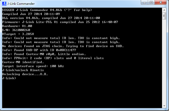

Hui_Ma

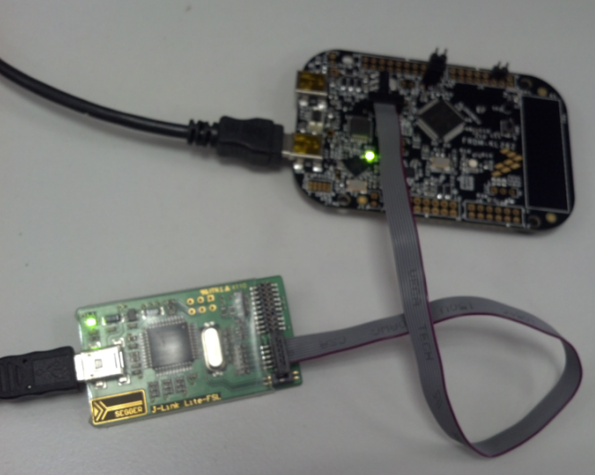

I do a test with FRDM-KL26Z board and J-Link Lite with below connection:
The J-Link Commander with below info, it shows the unlock command run normally.
From your J-Link Commander window, the VTarget power is 0V, which shows there is no power on KL16 chip.
Wish it helps.
best regards
Ma Hui
