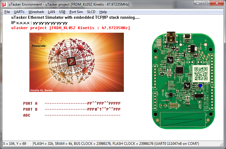

mjbcswitzerland
Specialist V
Hi Dan
I didn't see anything obviously incorrect but I suspect that you have a problem with the NVIC configuration somewhere (although the vector number is correct).
Therefore I set up the same configuration in the uTasker project - see code below (this is an API so doesn't show the register setup details) but in the PORTA_PCR11 register it sets 0x000a0103 which you could check yours against (this is enabling pull-up too).
INTERRUPT_SETUP interrupt_setup; // interrupt configuration parameters
interrupt_setup.int_type = PORT_INTERRUPT; // identifier to configure port interrupt
interrupt_setup.int_handler = test_irq_A_11; // handling function
interrupt_setup.int_priority = PRIORITY_PORT_A_INT; // interrupt priority level
interrupt_setup.int_port = PORTA; // the port that the interrupt input is on
interrupt_setup.int_port_bits = PORTA_BIT11; // the IRQ input connected
interrupt_setup.int_port_sense = (IRQ_FALLING_EDGE | PULLUP_ON); // interrupt is to be falling edge sensitive
fnConfigureInterrupt((void *)&interrupt_setup); // configure interrupt
When the interrupt is triggered the UART output (on virtual COM port of the FRDM-KL05Z at 115200Baud) writes "IRQ_A_11" and also the RED LED is toggled so that the interrupt is seen on the LED colour as well.
The blue LED is toggling every 500ms (I think that yours does this).
You can use a debugger to compare all registers to see what is different. There is also a memory debugger on the UART (hit ENTER and then go to the I/O menu).
I also attached a FRDM-KL05Z (also in the ZIP file) simulation (screen shot below) which I used to quickly set up and test the operation. You can run it be simply double clicking the EXE (doesn't need installation) and you can also test the IRQ operation [the Blue LED is toggling and you can change the input state of PTA11 by clicking on it - you will see that the interrupt fires and the RED LED is controlled as on the HW].
Mark
