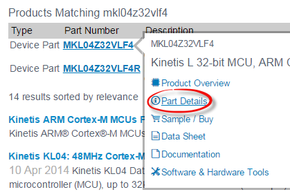

You can find the CAD footprint and symbol on the the web, you just need to search for the part number:
click on it and select "Part Details":

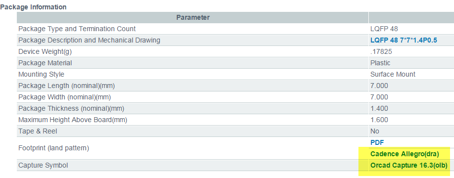

under package information you can find the capture symbol and footprint with a link to download the corresponding files:
Hope it helps!
