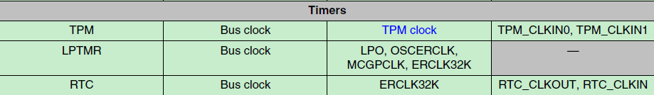

I have the TPM module running off the OCERSCLK from an exterior crystal at 6.144MHz. When I have the core clock set to run off the same crystal, my TPM output is perfect, exactly as I expect. When I change the Core Clock to 3MHz HIRC internal clock, the TPM output looks pretty close to normal, although it seems to be slighly affected by the clock change. When I change the Core Clock to 2MHz LIRC, the TPM output is not normal at all. Channel interrupts occur out of the blue when they shouldn't and the counters do not appear to be counting properly. When I change the Core Clock to 8MHz LIRC, there is no TPM output at all. Any idea what is causing this?
When I read through the user's manual, the best I could find is the excerpt below.
Could my core clock be causing problems with the TPM module in a similar manner to the external clock mode even though I'm not using the external clock mode? If so, how? I thought that the TPM module would be isolated from the core clock since it is running off it's own clock. Is there a rule-of-thumb for this?

I'm not sure that you understand my problem. My timers are running off an external 6.144MHz clock that is being brought down to 307.2kHz for TPM1 (PWM) and 19.2kHz for TPM0 (BPSK). When I run the core clock off the same external clock (6.144MHz) everything works fine. However, when I change the core clock to be internal HIRC 3MHz or LIRC 8MHz and LIRC 2MHz (no changes to the timer clock) it does not work properly. It is especially bad at LIRC 2MHz, the interrupts are not happening at the right times. SO...the timers are still running off the external clock...I have only changed the core clock.
I'm trying to understand why this is. I'm guessing that it has something to do with the bus clock since the bus is what clocks the interrupts correct? So, even though the timers are running independently with an external clock, they are still affected by the core bus clock. Is there a rule of thumb here? Should the bus clock be related to the timer clocks in some way so as to keep them synchronized properly?

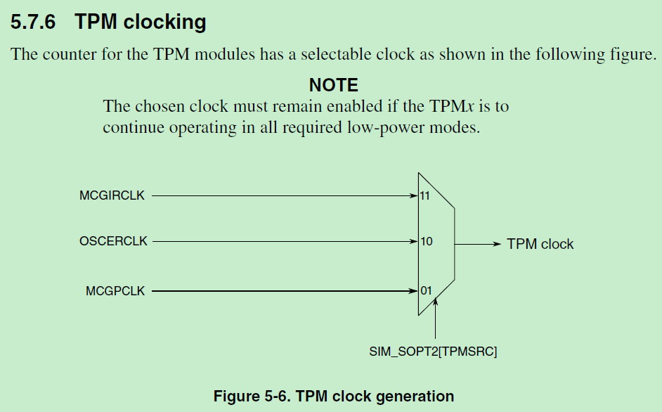

The KL03 reference manual shows the module clock source:
The Bus clock for TPM module interface clock, core using bus clock to access TPM module registers.
The TPM clock below is for TPM counter clock source:
From my point, if the core/bus clock using KL03 internal clock source, the TPM interrupt generation could not be affected. Your mentioned behavior is quite strange.

Yes, I am familiar with these tables from the manual. So, if I understand you correctly, the bus clock and the TPM counter clock do not need to be the same? I don't read that from the tables.

The bus clock and the TPM counter clock do not need to be the same clock source.

sarastout-grand
Hi Hui,
I got the attachment, you were right, changing the browser made a difference.
I believe I have sorted out my problem. My interrupt routine was taking too long when I slowed down the core clock. After cleaning up the code in the ISR, I was able to get things working with the slower internal clocks.
