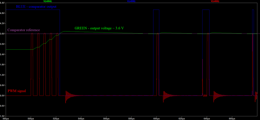

Here I must use TPM to generate like 200 kHz swiching frequency to increase voltage. Then I must use comparator to "check" the voltage when it reaches desired output voltage. If it rises to much, I should disable the TPM and then enable when falls again. So I have "stable" output voltage.
Here is visible how comparator turn high and then PWM turns on to charge capacitor to 3,6 V. So we have pretty stable 3.6 V ouput.  If I do it with SW that consumes a lot of MCU time.

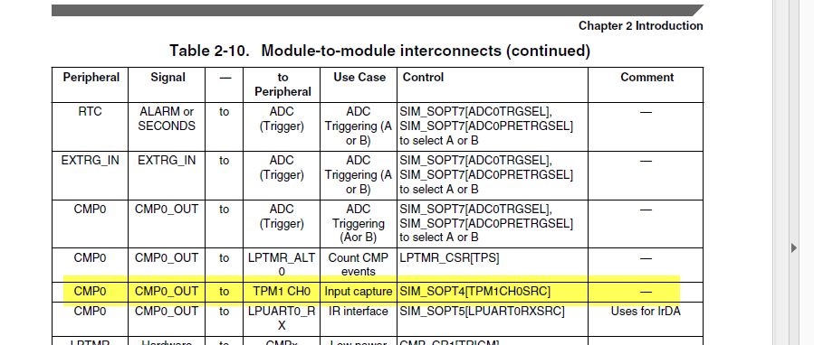

    CMP and TPM module have the internal connect, just like the table 2-10 in reference manual:
    It connect CMP0_OUT to the TPM input channel.
