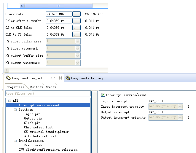

I use k10 to access SPI Flash(SST26VF064B). Data write and read is correct

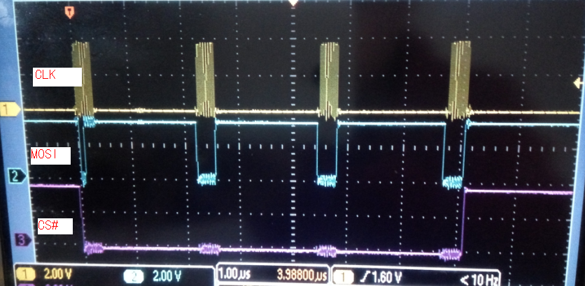

BUT: interval time between multi-Byte transfer is too Long, so the performace of spi is very low
WHY??
SPI-CLK is  24.576Mhz, one byte transfering takes 300ns. but interval time between multi-Byte transfer is 2us.
I use PE, enable spi interrupt to control transfering,

kerryzhou
Hi zeyong yang,
   From your SPI bus wave, I think it's related to your API code or your SPI calling code.
   If you don't want there has too long time between each byte in the SPI bus, I suggest you use the interrupt method, and send multiple bytes together instead of send one byte by one byte.
   Please modify your code to interrupt mode, and try it again.
   If you still have question about it, please let me know!
Kerry

yangzeyong
Hi,Kerry Zhou,
        I think i have use the interrupt method .
        The sending API sends multiple bytes togerther In ONE valid CS#. I do not know the  interrupt mode you said.
        Probably API inner code  cause long interval between bytes
        thank you!

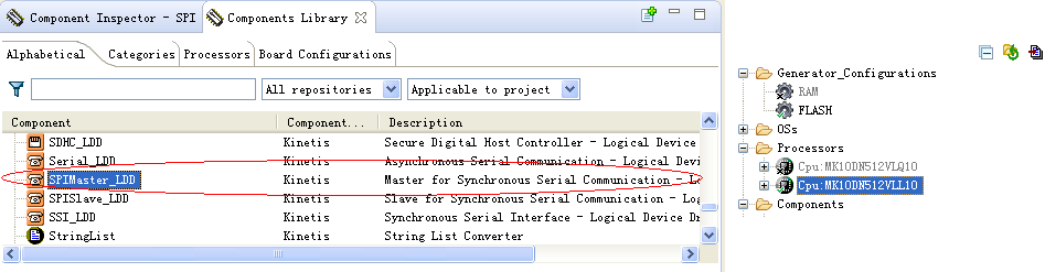

kerryzhou
Hi zeyong,
   PE code is a little redundancy, it's not simple.
  Please open  SPI_SendBlock, and SPI_ReceiveBlock, post the code, you will find may still call other functions.
  Please tell me what the PE SPI component you are using, and also tell me what the K10 chip you are using now?
  If you want to minimize the delay time between each byte, I suggest you don't use the API function, you can use the register to control it, then use the interrupt, it will send the byte by byte very quickly.
Kerry
2,221 Views
yangzeyong
Hi,Kerry Zhou,
       The API SPI_SendBlock and SPI_ReceiveBlock  code are below:
I use SPIMaster_LDD component  and MK10DN512VLL10
I like to use PE, this tool is convenient.
Thank you!
