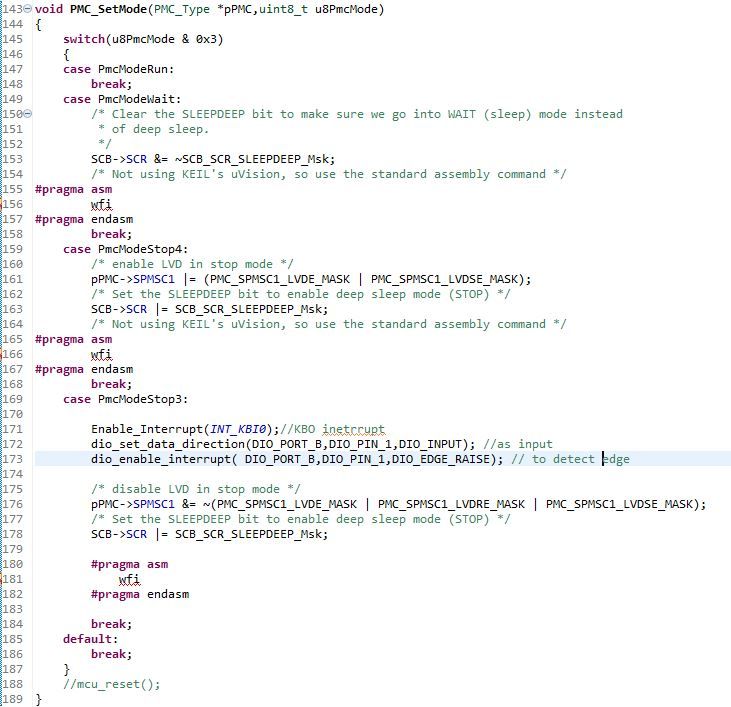

Hi @zhangzhiyong @jingpan  ,
Thanks for sharing above, i am also able to achieve it with current <1mA, however i want to wakeup from low power mode(Stop mode) and start with Run mode.
But my KBI interrupt or Low power RTC(~1Khz) interrupt is not getting.
Please help me on this so that i can wake up controller on interrupt.
one more thing once i use wfi instruction then i am not getting interrupt.
I tried with attached piece of code, i am using PmcModeStop3.
