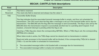

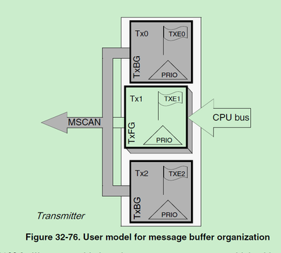

kerryzhou
Hi Roc_Wang,
    As you know, the KEA128 MSCAN TX has 3 MB,
So, you can use MSCAN_CANTFLG[TXE] to check which MB.
3bit means 3 related MB.
Wish it helps you!
If you still have questions about it, please kindly let me know.
Kerry
