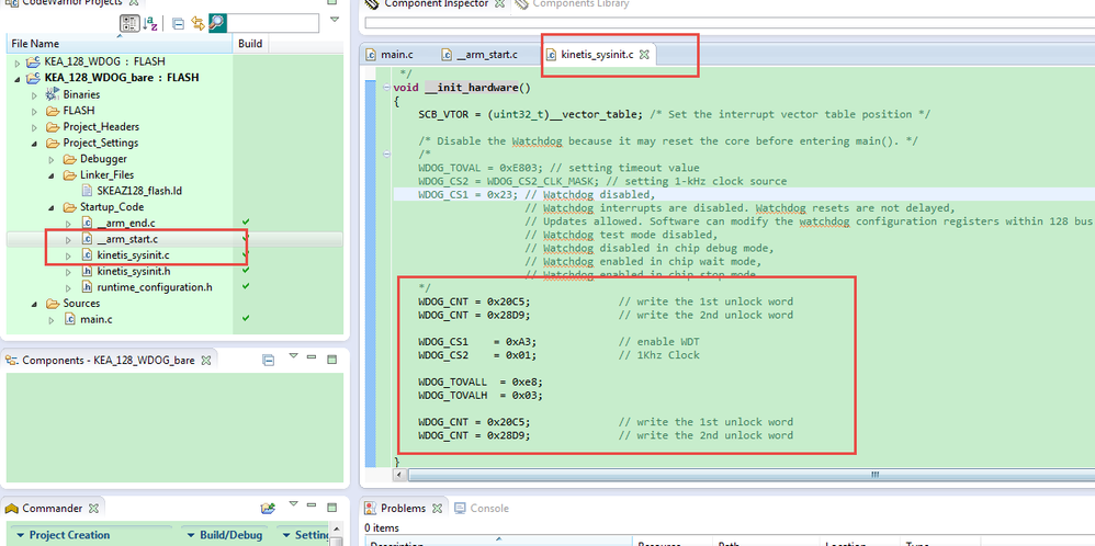

      Did you create the CW barebone project?
    If yes, did you modifiy the _arm_start.c file?
    Because in the __init_hardware() function, it disable the Watchdog, and register WDOG_CS1[EN] is the write-once bit after reset.
    You can add your SWD configuration code in the __init_hardware() function, then  your watchdog will works ok, I already test it.
  __init_hardware() is in file kinetis_sysinit.c.
Attached project is my barebone WDOG project, just for your reference.
Wish it helps you!

kerryzhou
Hi Robin S,
Wish it helps you!
Jingjing

Robinwithu
Senior Contributor I
Hello Jingjing,
Thank you very much  and Thank you Mark Butcher,
Yes i am creating bareborad project.
The code is working fine as you mentioned in your reply, it was Start up code file  Configuration problem.one more thing i would like to ask you , in your kinetis_sysinit.c file  you have unlock the WDOG at the start  and at the end inside  __init_hardware() function, why do we need to unlock it two times(specially at the end of the function)?

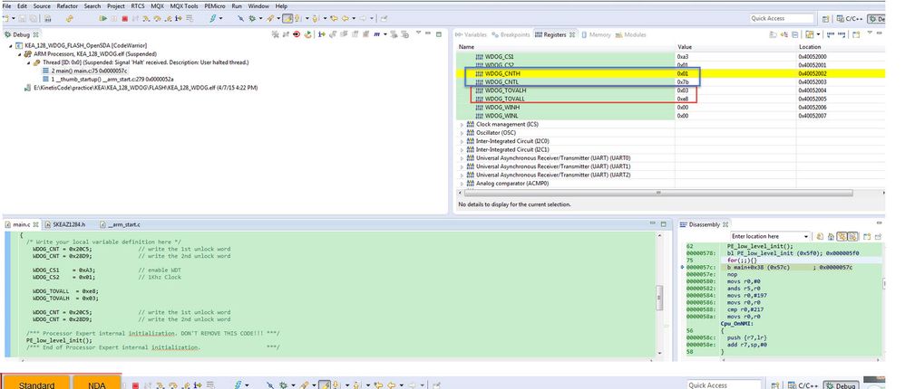

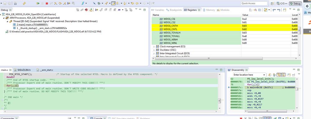

As you mentioned in your comment in debugging mode i have to wait for sometime and then pause the code to see the changes in WDOG counter i did but their is not any changes in WDOG counter , it always remains at 0x00(Both higher n lower bytes).
is that mandatory to define WDOG_TOVALL or TOVALH , can't it automatically take the value in Lower eight bit if the value is define in decimal,because before this i was using 8 bit controller S9S08RN8 n for that it has worked, I also tried as you mentioned by writing Higher and lower byte of WDOG_TOVAL register but it doesn't work.One thing i would like to add here , in Debug mode i have seen that it configured the WDOG_TOVAL register correctly.(WDOG_TOVAL=10)
As jingjing mentioned in his comment that for debugging i need to activate debug mode in WDOG control register i also did that but it doesn't work.
I also tried with System clock Frequency at 20Mhz by changing the WDOG clock but i didn't get any changes.WDOG is never resetting the controller.
One strange thing which i noticed  is that  when i am Flashing the controller, in my console window  i can see that the code is Flashed Successfully and it's also showing me the WDDOG configuration Register values which are Default values like
WDOG_CS1=0X23;
WDOG_CS2=0X03;
WDOG_CNTH=0x00;
WDOG_CNTL=0x00;
WDOG_TOVALH=0x0e;
WDOG_TOVLL=0xe8;
but in Debugging mode it is showing me the correct configuration of all WDOG Registers.I Read in someone's post it has something to do with NMI (Non-Maskable Interrupt) pin but not able to understand whats exactly it does.
Note : I am not using any interrupt so at the start of code i disabled all the interrupts
