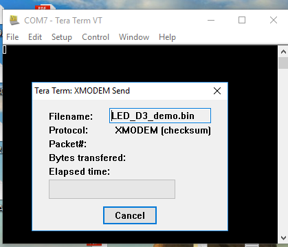

Hello All,
I have downloaded code from this link:  KEA128 CAN Bootloader.   I am using 2 x FRDM DEV BRD KEAZ, KDS and Tera Term. Later I would like to port code from KDS to S32. Problem is that code originally was written for different micro and different boards. Below Com12 picture shows that Bootloader_KEA_128 board sends. It looks that bootloader is working on Bootloader_KEA_128 board. Picture Com7 shows UART_CAN terminal where I am trying unsuccessfully to send LED_D3_demo.bin file. I think it is not working and I don't know that is wrong with it.
Questions:
a) Could anyone help me?  (For UART to PC communication I am using  FRDM DEV BRD OpenSDA) .
b) Does anyone knows where to get  UART bootloader for KEA 128 code? Or maybe other micro code which could be easily ported to KEA128?
Irmantas

Hello Irmantas,
For the bootloader KEA128 CAN Bootloader.
As to the board K20 OpenSDA debugger cannot meet the boot loader transmit speed requiremtns,
so you need use UART port connect to an external UART-USB , then connected to PC USB port .
Alice

I have ported UART-CAN code to KEA128 and it is not working. XMODEM doesn't transmit .bin file via UART.
Is where any working examples for KEA?
Code is written in complicated manner... I can't find where UART configuration is in UART-CAN(channel, speed,pin number for UART etc) code?
Irmantas

Hello Irmantas,
- There are other ports bootloader for KE chips, it can easy porting to KEA:
KEA 128 Boot loader
Uart bootloader
- About  UART-CAN, the CAN configuration code is in the function :
UART_InitPrint();
Alice
