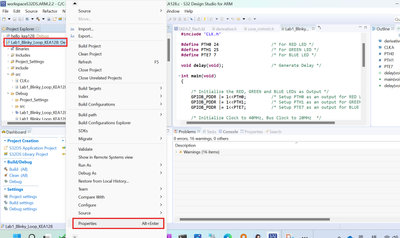

I'm using S32DS for ARM v2.2 and downloaded the Quick Start Pack.
I imported Lab 1 and attempted to build it, but I get this error:
ewl_c_noio.specs: No such file or directory
The system is expecting to find the arm_ewl2 directory under C:\NXP\S32DS_ARM\S32DS and it's not there.
Where can I get this library so I can build the quick start sample projects?
2,696 Views
Celeste_Liu
Hello @hns80 ,
This issue can be resolved by replacing the "libraries support". Please refer to the following steps:
1. Right-click on this project and select "Properties".

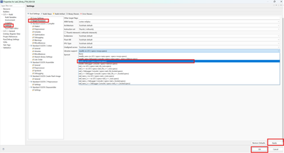

2. Refer to the following screenshot and change "Libraries support" with "newlib no I/O (-specs=nosys.specs)". After the replacement, click "Apply" and then click "OK".

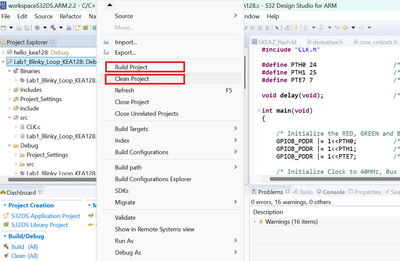

3. Clean the project and then build the project, and it can be successfully compiled.
Hope it can help you.
