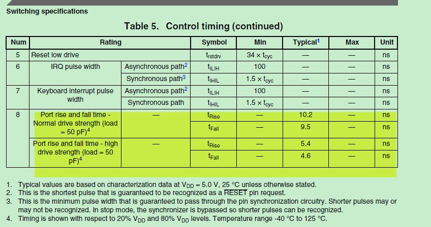

Thanks for information, The port rise time and fall time refers to output port.

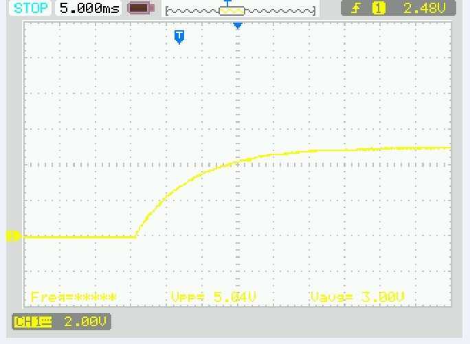

In our design we have series R = 18K and C = 0.47uF on the digital input pins which makes the RC time to be 8.46 mseconds, for rising edge or falling edge single is this fine for the digital inputs for detection of state change ?

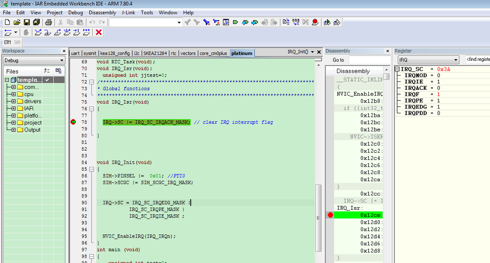

    Take the IRQ as a example, it just defined the min pulse width.
    But don't worry, the input rising and falling time should just limit by the min pulse.
    I have test the about 15ms rising edge on my side, the IRQ also can detect the rising edge.
   You can see my test result:
The rising edge is about 15ms, but the IRQ rising edge detect also can work, so your 8.46ms rising edge or falling edge single is fine for the digital inputs for detection of state change.

    About the slew rate, you can find it from the datasheet, the name is the port rise and fall time.
More details about the module time, you can refer to the KEA reference manual.
