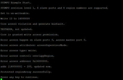

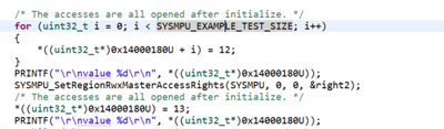

I use the sdk to make a simple test.
I set the address you mentioned.
Then I test the address.At first, the address can be accessed. Then I modify the rights. 
You can see the result. We can print '12'. But we can't print '13'. Because the mcu goes to bus fault.

nxf56274
At first, read and write rights. We can write and read. Then the rights is read and no writing. So we can't give '13' to address. You can use this example and change the address. You will get the results very soon.
