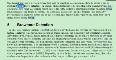

  1. When writing data to FlexRAM is there a possibility of a partial or corrupted writes to backup EEPROM if a power interruption occurs during the time the file system is writing to backup EEPROM?
Answer: Please check the AN content:
