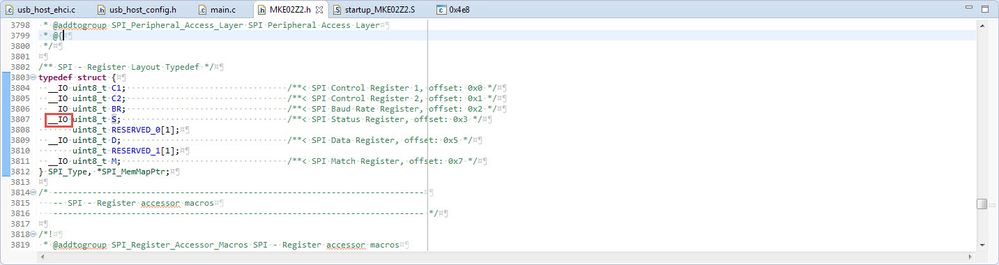

  • In Kinetis Family, some flags need to be written by '1' in order to clear them, in this case, you need to modify the MKE02Zx.h file and add the _IO feature in the SPI_S register:SPI_S register KE02Z.jpg
This way you will be able to write to this register and clear the flag:
if (SPI0->S & SPI_S_SPMF_MASK)
    SPI0->S |= SPI_S_SPMF_MASK;

About second one: from SW point of view declaring __IO instead of __I will solve.
But from MCU side, its reference manual is reporting that SPI0_S is read only. Sometimes I used to read w1c (write 1 clear): is it just a documentation issue?

Hello Roberto,
It seems to me that this is a documentation error and I need to validate it with Documentation team. Because when I modified the const modifier in the header file, flag could be cleared correctly.
