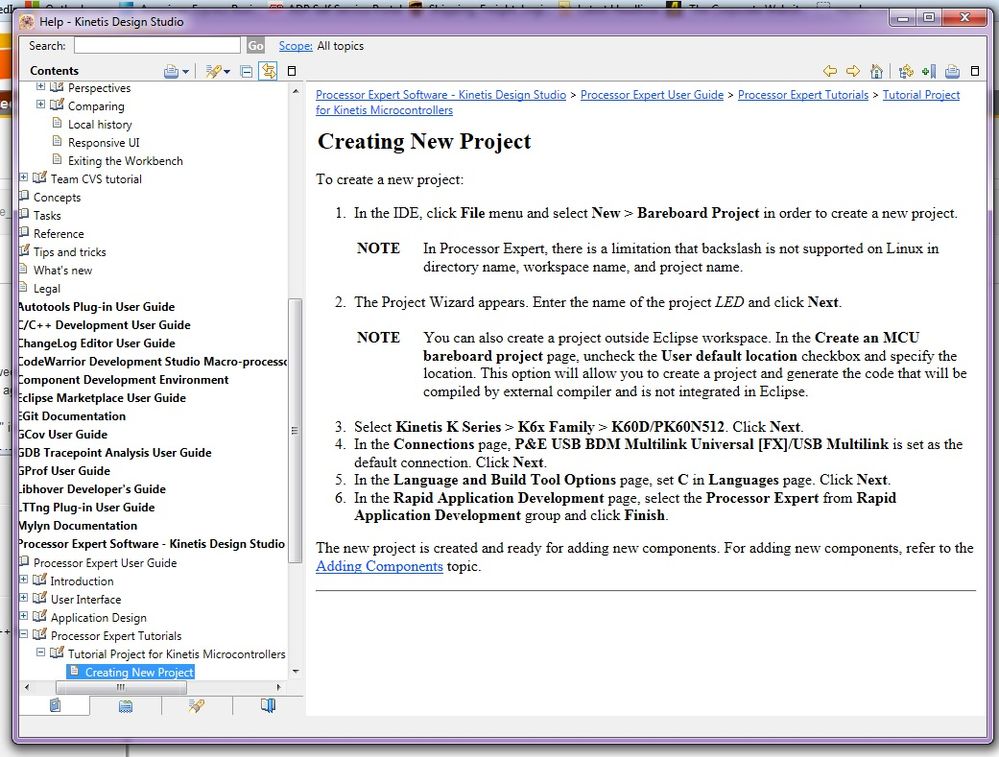

After beating my head against the wall for a week trying to get a very simple IAR-based FRDMKE02Z board project working, it was suggested that I try the KDS Processor expert for peripheral configuration assistance. I downloaded and installed the KDS, and once again, confusion reigns. I thought I'd try the tutorial for making a new project. First instruction: "In the IDE, click File menu and select New > Bareboard Project in order to create a new project."
Unfortunately, there IS no "Bareboard Project" in the file menu. There is this:
Note, no "Bareboard Project". So, which option is the one I need to use instead? What other documentation errors have others found?

Hello Dave:
What tutorial are you referring to?
I checked the file kds_user_guide.pdf which comes with KDS installation (C:\Freescale\KDS_2.0.0\doc\pdf) and it actually says "File -> New -> Kinetis Design Studio Project".

davetelling
Jorge,
Here is a screenshot from the help file, it may be that I did not specify that I was trying to learn how to use the Processor Expert, I didn't know about the other docs you referenced:
I'll see if the guide you listed will cure some of the cobwebs, thanks!

robotjosh
Looks like they converted a codewarrior document to kds without changing everything.  A lot of stuff like that is broken.  You want kinetis design studio project, then processor expert and not kinetis sdk (its buggy).  You might have to install a patch that allows processor expert.  You can still use codewarrior 10.6 it looks a lot like kinetis design studio but does not support KL or new chips and does support hc08 and lots of old stuff.
