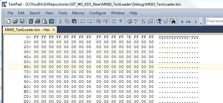

henrynguyen
Hi Erich,
just an update, after i try to erase / program the proper .elf file using Segger IDE, the board seems to be working again now... Pheeee.  i am still not able to know if the attached application project that i intend to be loaded by boot loader to 0x40000 is properly compiled or not.  i check the CRC starting from 0x40000 until the length of the bin, the 32-bit CRC matches.
i used this to jump to 0x40000
void start_application(unsigned long app_link_location)
__asm(" ldr sp, [r0,#0]");
__asm(" ldr pc, [r0,#4]");
... then later in the main file, after checking CRC matches, i proceed to jump to 0x40000 as:
if(Firmware_CheckIntegrity())
   TRACE_INFO("Run tool firmware...\r\n\r\n");
   start_application(0x40000);
do you see any potential issue in my tested application codes (compiled for 0x40000) and the way to jump to 0x40000 after CRC check is correct?
Henry

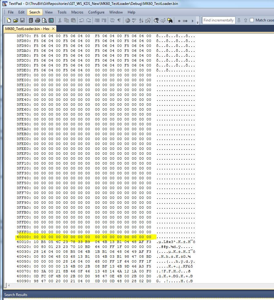

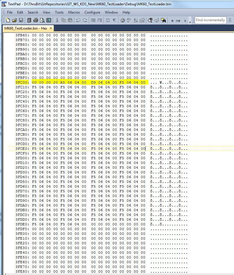

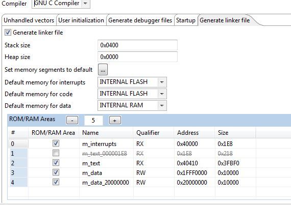

henrynguyen
Hi Erich, Alice,
thank you for your reply.  So, user has to set the correct .ld file for each configuration.  I was hoping that the CPU component in PEx linker file in build-options can be changed for each configuration, but it seems that it is not.  No problem i can have custom .ld for each configuration and called them appropriately.
About the case that i defined the application starting address at 0x40000, i use generated raw binary file option in the property setting and it generated the binary, but it appended 0x0 all the way to 0x3FC00.  Please see the 3 attached files.
I wonder if there is anyway we can skip the appending of 0x0 because when i load this .bin by the boot loader, the value at physical address 0x40000 is not the beginning of the application codes.  when we use Keil uVision to convert the .axf to .bin, there is no appending of 0x0.
- top of the application .bin file, it has 0xFF and then bunch of 0x00
it fills 0x00 until 0x3FC00 where it seems to have the vectors for application codes.
I am not sure why the vectors are mapped to 0x3FC00 like this.  if you see my linker configuration setup below, it should start at 0x40000.
Linker setting for this binary file.
can you please advise if i am doing anything wrong?  what i like to do is to have the binary codes to be loaded at 0x40000 by boot loader and start from there.  I can get the boot loader to save the .bin there correctly because i have done the CRC-32 bit check.  but the image starting at 0x40000 is exactly what i have shown in the binary above.
Henry

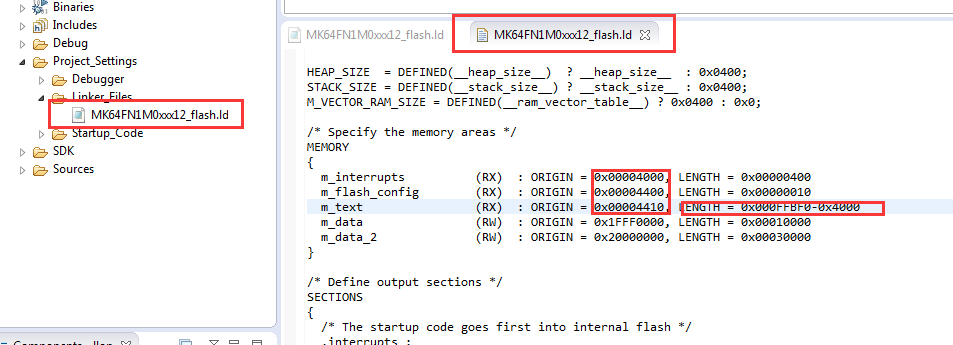

Please open linker file (.ld), then configure the MEMORY part , for example like this :
Hope it helps
