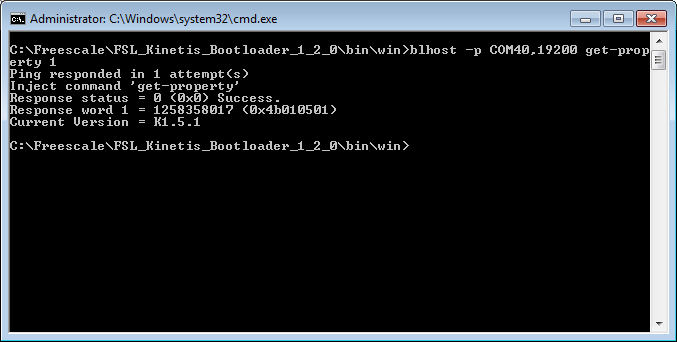

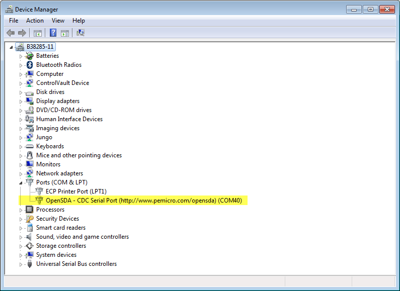

Hi Christie,
Please make sure that the COM port number used in the command is the correct one, also notice that the baud rate is automatically determined by the bootloader when processing the initial ping. Thus, subsequent blhost invocations must specify the same baud rate as was used for the initial invocation unless the bootloader is reset. If the baud rate is not specified using the -p COMx,<baudrate> option, the UART baud rate is set to 57600.
I have done some tests using the same bootloader project and it is working correctly:
My FRDM-K64F has the COM port 40 assigned:
In the command prompt I type the command blhost -p COM40,19200 get-property 1:
Hope it helps!

a8Chcx
Hi Carlos,
It works on my side as well. I have to input the full command, not only "-p COM1".
