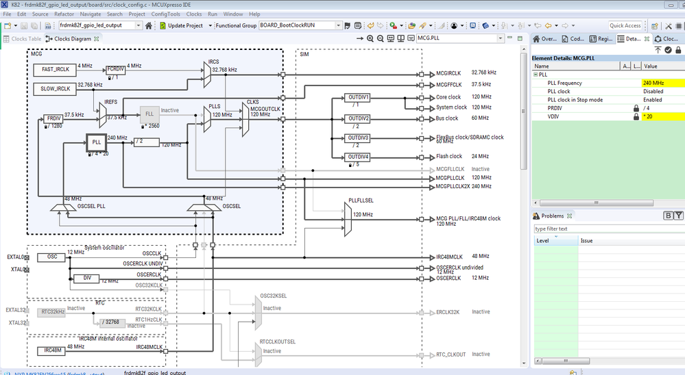

I would like to create optimal clock tree for my configuration. I think by using it I can have less power consumption
in RUN mode and LLS mode. And have fast wakeup from LLS3 to RUN by using external/internal LLWU as wakeup source.
I have both crystal oscillators and use couple I2C ( mastrer and slave), RTC, WDOG and LPUART for debug terminal.
LTC and TRNG in use as well. LPO is need for LLWU.
I can see from DS that IRC48 if used consume something and better to avoid usage of it.
I need core/system clock 120 Mhz and Bus clock 60 Mhz.
But MCG might have different configuration.
LPUART can take clock from crystal oscillator directly.
What can be overall clocking scheme recommendations what lead to lower power consumption and fast wakeup
from LLS3 by using LLWU ?

Hi Eugene Hiihtaja,
     If you want to use internal IRC48M, you can use the IRC48Mhz as the PLL input ,then configure it like this :
You also can use the MCUxpresso Config Tool to configure it.
But about the low power consumption, if you work with 120Mhz, the power consumption won't be very low, unless you enter the low power mode.
Wish it helps you!
Kerry

Yes I'm using MCUxpresso Config Tool as initial configurator for my project.
MCU wakeup to 120Mhz quite rare and other time stay in LLS3 mode.
But in documentation mentioned that wakeup time is depends from clock configuration due stabilisation time for some clock units.
And I also believe that minimal path in clocking tree should bring some saving.
In LLS3 mode , proper GPIO pin configuration for all unused pin might have major effect.
