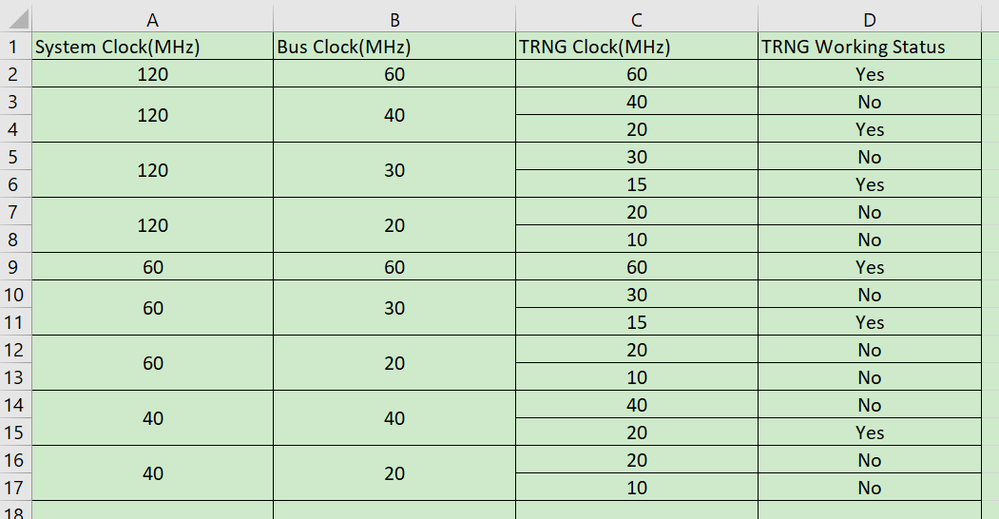

Hui_Ma
Hi Eugene,
I use your attached code and could generate your mentioned issue.
Then, I do a test with different clock frequency and check TRNG working status.
Please check below test result:
There with below description about TRNG working scheme:
TRNG is based on collecting bits from a random noise source. This random noise source is a ring oscillator that is sensitive to random noise (temperature variations, voltage variations, cross-talk and other random noise) within the device in which the TRNG is used.
The ring oscillator clock frequency doesn't mentioned in reference manual.
From the test, the TRNG working status quite related with bus clock and itself clock frequency.
Thank you for the attention.
Mike

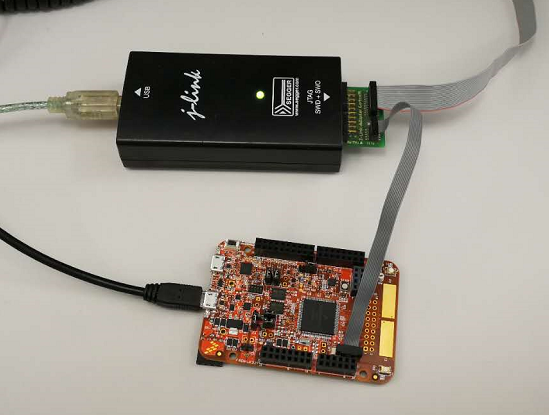

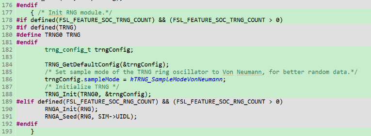

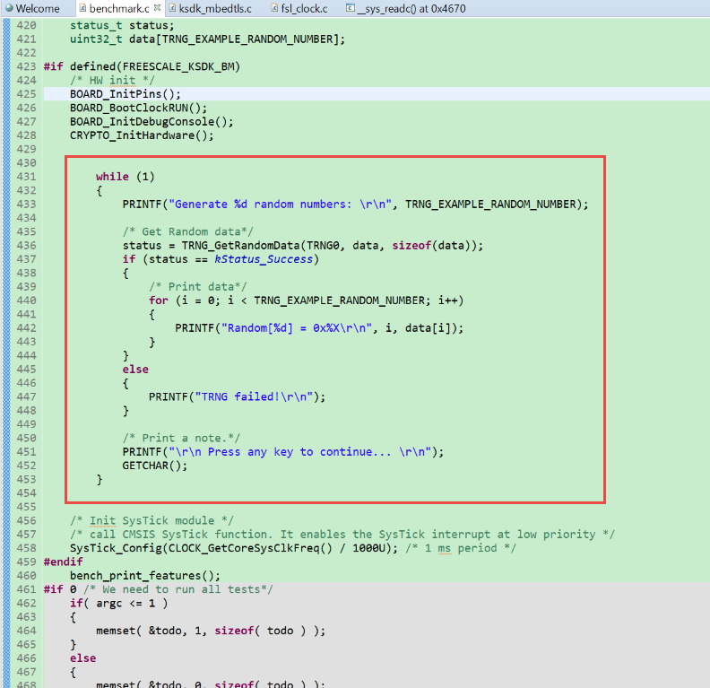

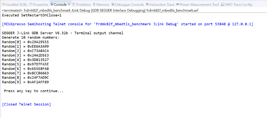

I did a test with MCUXpresso SDK provided <frdmk82f_mbedtls_benchmark> project and didn't find your mentioned issue.
My hardware test environment is below:
I checked the TRNG0_MCTL register value, the [OSC_DIV] value is 0x0.
I didn't modify the [ksdk_mbedtls.c] file, which with below code to initialize TRNG module:
I copy <trng_random> project code to [benchmark.c] file to generate random numbers:
I also attached my modified [benchmark.c] file for your reference.
I didn't meet any issue with above code.

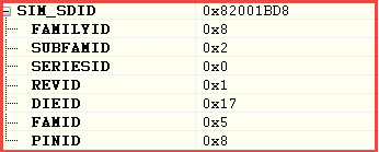

Hui_Ma
Hi Eugene,
Please check my FRDM-K82F board SIM-SDIO register info:
I tried two FRDM-K82F board with same results (could not regenerate your mentioned issue).
