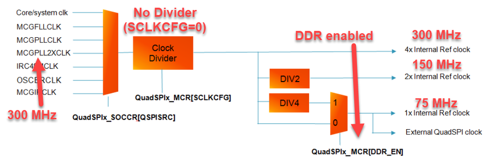

Hello Eugene,
Please check the following extract from the reference manual.
DDR mode of the QuadSPI requires a 4x, 2x, and 1x internal reference clock. In DDR mode, the clock divider output is used as the 4x internal reference clock. The 2x and 1x clocks are divided down from that clock.
To generate the maximum 75Mhz flash frequency supported in DDR mode, MCGPLL2XCLK should be 300MHz with QuadSPIx_MCR[SCLKCFG]=0 to generate the 4x internal clock required.
This means the following example:

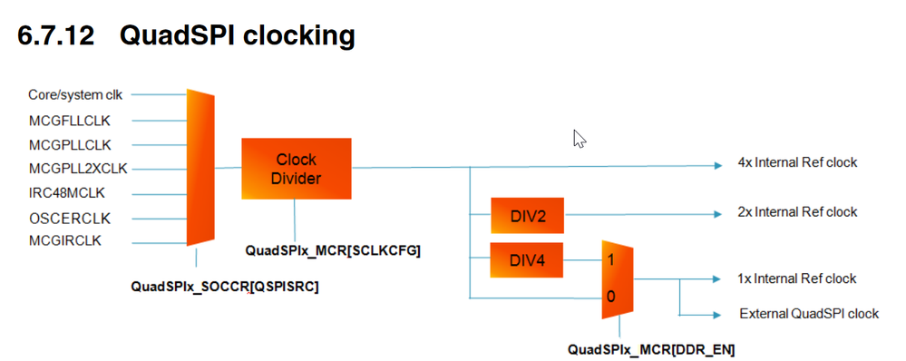

Can be look our configuration in more details. Chapter 6.7.12 QuardSPI clocking is not so transparent.
I'm using
/* Set clock source to kCLOCK_CoreSysClk */
config.clockSource = 0U; // 120 Mhz
And enable quad mode.
How in this case I can understand RM notice:
"The controller supports singles,dual,
quad or octal data lines in single (SDR) or double (DDR) data rate configurations. SDR
mode supports upto 100 MHz and DDR mode supports up to 75MHz.
So this is External QuadSPI clock limit ?  Not clock source limit ?
In this case in case of write I should drop Internal reference clock to 120Mhz from 480Mhz what is applicable for read operation.
In this case QuadSPIx_MCR[27:24] divider should be 4  ( value in register 3.). Is this so ?

After initialization register has value QSPI0 MCR 0x040F000C and clock divider is 4 there. DDR is not enabled.
It means External QuardSPI clock is 30Mhz.
Is this so ?
Eugene
3,229 Views
FelipeGarcia
Hello Eugene,
Yes, that is correct. Please check snippet attached from reference manual chapter 6.7.12.
Felipe

It mean that text in RM
is talking about ExternalQuadSPI clock or clock what should be visible after Clock Divider.
Is this so ?

FelipeGarcia
Hello Eugene,
Hope it helps!
