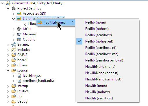

You don't have much control what the GNU library does: internally it can use malloc() for things like printf() or file I/O. Another reason not to use the prinf() of the library. But what you can do is to disable at least some of it with selecting a 'none' or no-host' library variant:
The other way is that you overwrite the malloc() and free() functions with your own version to trap all usage of it.

I have MPU enabled environment  and any extra memory accesses to unknown area cause faults.
In linker file I set nohost version already
/* Redlib Nohost */
GROUP(libcr_nohost.a libcr_c.a libcr_eabihelpers.a)
And in project settings it show nohost-nf like you recommend.
printf() is not used for sure but snprintf() is used for cook formatted strings.
Also FreeRTOS in some debug places use sprintf() functions.
