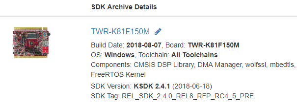

I am trying to send my board to LLS state ( basically i want to just turn off everything) and then i want to wake it up using an LLWU interrupt.
Do you have a sample code to achieve that?
I am using MCUXpresso IDE v10.2.0_759 and SDK_2.4.0_TWR-K81F150M.
Thanks.
