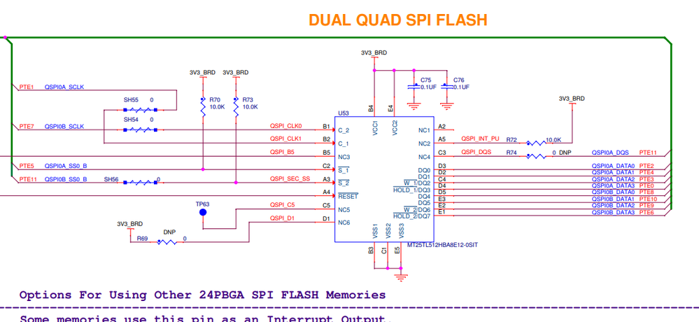

chailiming
Hi Kerry
      My Test Board is TWR-POS-K81,  the QSPI Flash is  MT25TL512HBA8E12-0SIT.
Could help test SDK_2.5.0_TWR-K81F150M, Demo on TWR-POS-K81.

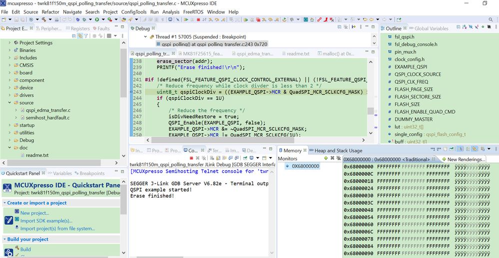

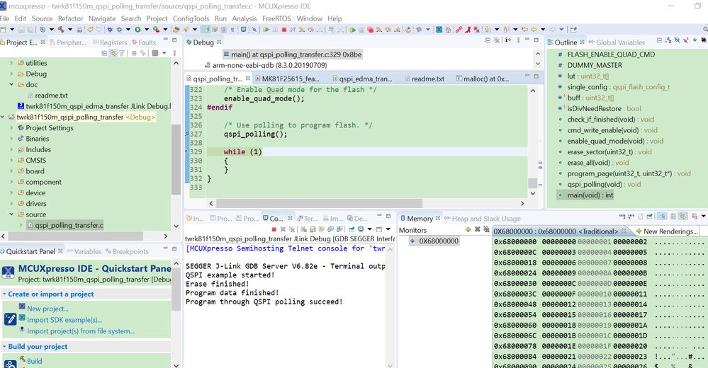

kerryzhou
Hi chailiming,
  Seems the reply edit has issues, I share you my test result on this reply.
Seems your post is misoperated as the solved item, please ignore it, and we still can discuss it, if you can, you can delete the solved item.
Kerry

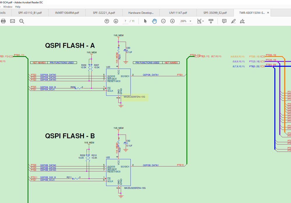

kerryzhou
Hi chailiming,
  Your SDK version is a little old, now the K81 newest SDK is SDK_2.5.0_TWR-K81F150M.
   Could you please tell me which board you are test now? And your external QSPI flash partnumber?
   I test the SDK_2.5.0_TWR-K81F150M\boards\twrk81f150m\driver_examples\qspi\polling_transfer on my TWR-K80 board, the qspi is:
MX25U3235FZNI
  The erase works OK.

chailiming
Hi Kerry
      thanks for your support, My Test Board is TWR-K81F150M,  the QSPI Flash is MX25U3235FZNI

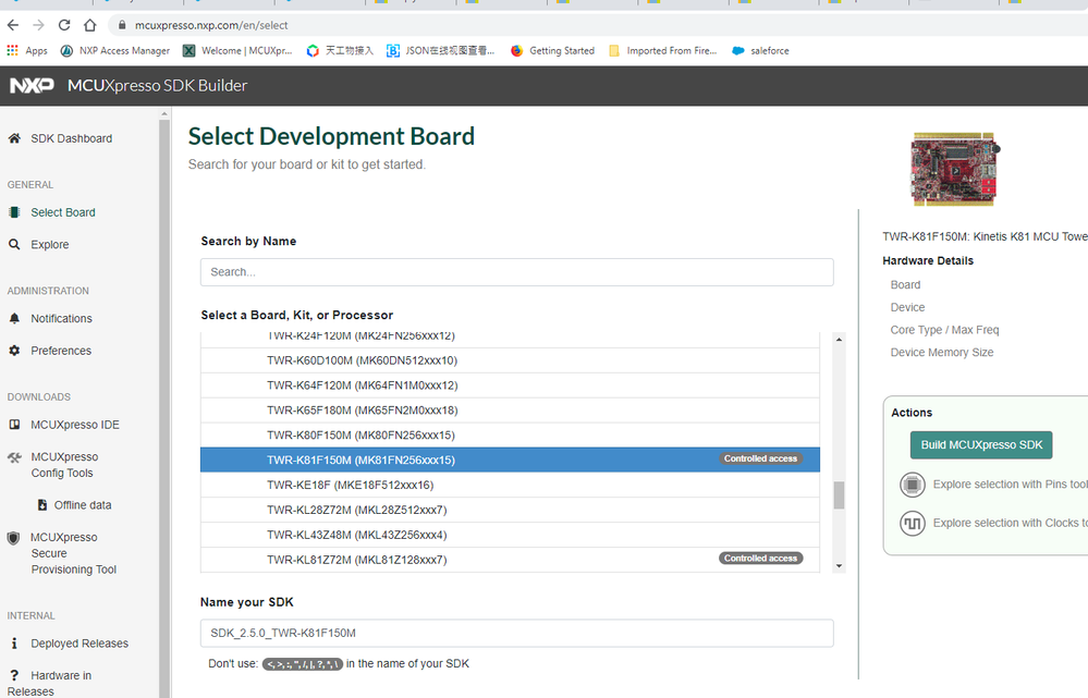

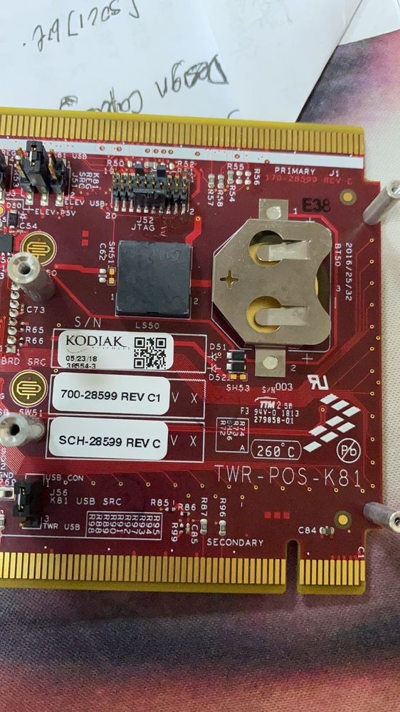

kerryzhou
Hi chailiming,
  Where you get the TWR-K81F150M board?
  From the nxp website? Do you have the link?
  Could you also please provide one photo about your TWR-K81F150M board?
 As I didn't find this board from the NXP website, so until now, I still don't have that board for testing.
MX25U3235FZNI is also the same as the TWR-K80F150M board, which I have tested yesterday.
So, it should works, because totally the same QSPI chip.
About the SDK, I can't send you directly, as it needs the NDA to download it.
You already have the old SDK version, so you should have assigned the NDA with NXP, and you should can download the newest SDK:
https://mcuxpresso.nxp.com/
Please try it on your side again.
So, now it should your SDK version issues.
Please download the newest SDK, and try it again.
Wish it helps you!
If you still have questions about it, please kindly let me know!
Kerry

chailiming
Hi Kerry

chailiming
