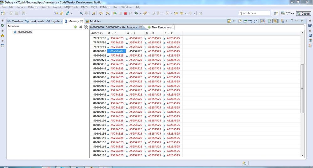

kayathrim
Hi Paul,
I wrote 0xA5A5A5A5  at address 0x80000000. if i read back, I am getting 0x25 at location 0x80000000.
1.I have tried to write 0xA5A5A5A5 at entire DDR2 memory location. if i read back, 0x80000000= 0x25 and 0x80000001 = 0xA5.  I have attached screenshot of the memory herewith.
2. At address 0x80000001 if i write value from 00 to FF and read back value is ok.
3. At address 0x80000000 if i write value from 00 to FF and read back upto 7F is ok. For 0x80 to FF value, it is reading 00 to 7F again.
Kayathri

vicentegomez
Hi Kayathri
if you have some boards that works properly and in other the same software is having problem, this locks like there is a hardware issue on those boards
Please check if there is not some missing  capacitor o component, please also check the lines for the DDR comunication,or maybe if the K70 is properly solder to the PCB
