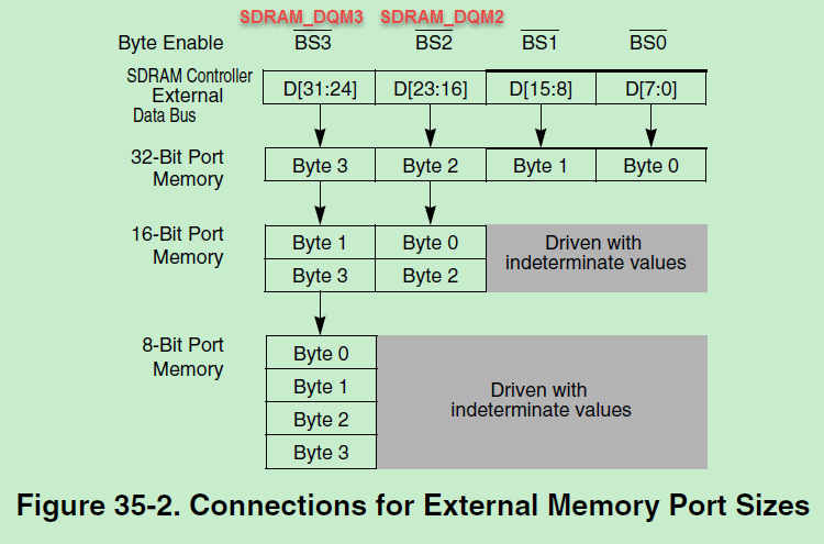

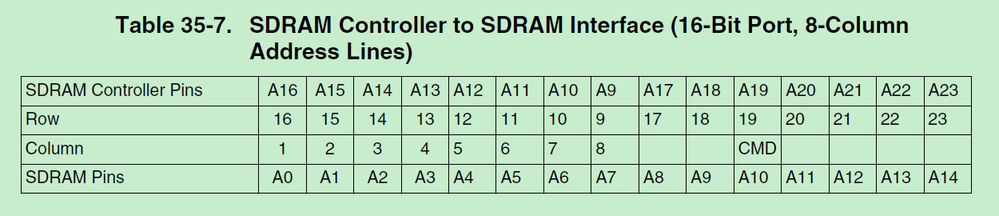

I am going to use MT48LC4M16A2 for 16-bit SDRAM mode with F66F MCU.
1. Could you tell what the address line connection between MCU and SDRAM?
2. Should I use DQM0, DQM1 to access it? Or I need to use DQM2 and DQM3?
3. Can I use 2 16-bit SDRAM to form one 32-bit by using DQM0~~3? Or I can only use 2 16-bit SDRAM by using SDRAM_CS0 and SDRAM_CS1? If so, any 128Mbit SDRAM to recommend?

1) Based on the SDRAM table, MT48LC4M16A2 only has A0~~A11, BA0:BA1, so I can't connect the required pin(A0~~A14) in table. Is it right?
TS: The reference manual mentioned: Most SDRAMs likely have fewer address lines than are shown in the tables, so follow only the connections shown until all SDRAM address lines are connected.
Customer can refer table 35-7, the MT48LC4M16A2's BA0 connects with K66 SDRAM controller's A21, MT48LC4M16A2's BA1 connects with K66 SDRAM controller's A22.
2) If I want to use MT48LC8M16A2P(128MB, 9 column), table 35-8 is right?
TS: Yes, that's right.
TS: Please refer K66 reference manual Table 35-7. SDRAM Controller to SDRAM Interface (16-Bit Port, 8-Column Address Lines) about K66 SDRAM Controller to SDRAM memory address line connection.
The SDRAM controller data line using below connection (K66 SDRAM controller doesn't provide SDRAM_D[15:0] pins):
TS: Please use DQM2 and DQM3
TS:  K66 SDRAM controller doesn't provide SDRAM_D[15:0] pins.
Customer need to use two SDRAM_CS[0:1] connect with two 16-bit SDRAM chips.
You could use MT48LC8M16A2P(128Mb) as a replacement.
Wish it helps.
Ma Hui

cutworth_wang
Hi Ma Hui,
For the answer to the 3rd question, I disagree with you. There is only 16bit data bus on K66 for its 144pin package. 32bit data bus is only possible with K65.
Also you cannot use DQM0 and DQM1 when data bus available is SDRAM_D31-SDRAM_D16. DQM1 and DQM0 correspond to BS1 and BS0 in Table 35-2 in K66 RM.
Hao

Hui_Ma
Hi Cutworth,
Thank you for the reminder.
The K66 without SDRAM_D[15:0] pins.
I will update the answer to customer.

Could you tell me where the possible problems are? The SDRAM configuration is right?
Christie
10,270 Views
a8Chcx
I did more testing today and found the following:
1) When I change the latency to 0(1 before), I can write and read, but there is 20% error.
2) If I write 16 bit, I found the error only on lob byte. High byte always right.
There is eh same result on block0 and block1.
Is it possible to be related on SDRAM timing setting?
Christie
10,270 Views
a8Chcx
I checked SDRAM chip spec. and should set the latency to 3(3-3-3). I tried 3,2,1 and always read 0.
If I set to 0, it reads back the right data, but not reliable.
Can anyone help me to find out where the problem is and how to configure SDRAM timing?
Christie
10,270 Views
a8Chcx
Is there anyone who can suggest to do any testing because I need to fix it and move forward?

Hui_Ma
3) Looks like that I can't form 32-bit by using 2 16-bit SDRAM because there is only SDRAM Data 16~~31, right?
TS: For K66 SDRAM controller doesn't provide SDRAM_D[15:0] pins, please check my updated comments below.
Customer need to use two SDRAM_CS[0:1] connect with two 16-bit SDRAM chip.
