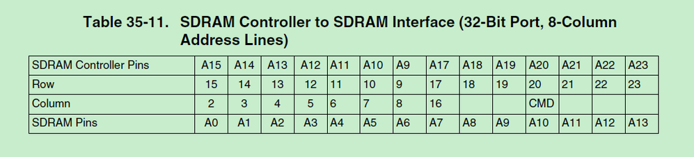

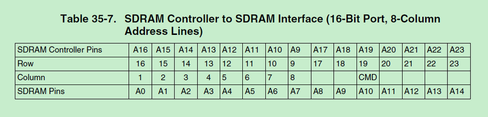

In my hardware I connect K66 to SDRAM via 32 bit port and 8 column adrress lines interface , but It doesn't work. Now, I want to replace 32bits SDRAM with 16 bits SDRAM. Can it works with my hardware connection.
Thank in advance.
791 Views
Hui_Ma
The K66 SDRAM controller supports 32-bit port and 8-Column address lines with below connection:
Please check if your connection match with above requirement.
And K66 SDRAM controller also supports 16-bit port and 8-Column SDRAM device with below connection:
Wish it helps.
