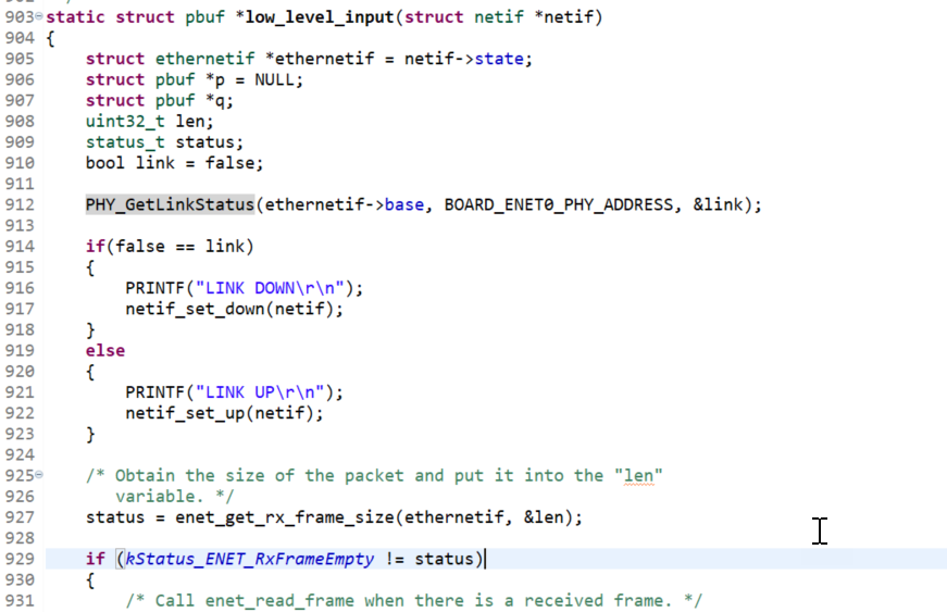

Hi Marco,
You could try to do something as follows to detect when the ethernet cable has been disconnected:
PHY_GetLinkStatus(ethernetif->base, BOARD_ENET0_PHY_ADDRESS, &link);
if(false == link)
    PRINTF("LINK DOWN\r\n");
    netif_set_down(netif);
else
    PRINTF("LINK UP\r\n");
    netif_set_up(netif);
Hope it helps!
Felipe

FelipeGarcia
Hi Marco,
I am sorry for the late reply.
I used the tcp_echo_bm example from the SDK and added those lines in ethernetif.c file. Right before to read the frame.
I hope this is helpful.
Felipe

mpazzi
Hi Felipe,
I've just tryed your solution, I'm using freeRTOS.
When the cable is connected I see "LINK UP", if I disconnect the cable no "LINK UP" or "LINK DOWN" appears, but when I re-connect the cable I see LINK DOWN and after LINK UP but the comunication is not working any more until the reset.
Any idea?
Thanks a lot for your support.
Marco

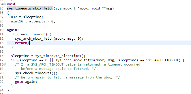

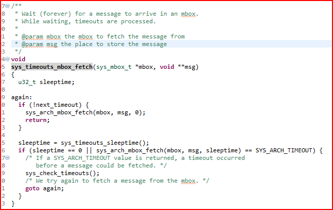

mpazzi
Hi Felipe,
I have tryed with TWRK65 demo board and I see that with one PC (maybe windows XP) the disconnecting and reconnecting of cable work fine, if I try with one PC (windows 10) the disconnecting and reconnecting of cable do not work.
Not working I mean the cable is connected and I use echotool command and I disconnect and reconnect the cable while the server is responding, the process in PC goes in timeout and after I can't have communication anymore.
Looking in code " tcpecho_thread(void *arg) " -> netconn_recv_data(struct netconn *conn, void **new_buf) -> u32_t sys_arch_mbox_fetch( sys_mbox_t *pxMailBox, void **ppvBuffer, u32_t ulTimeOut ) the last function is called (by sys_timeouts_mbox_fetch(sys_mbox_t *mbox, void **msg) ) with ulTimeOut with zero value that means wait forever and never return for close connection.
I hope to be clear enough.
Best Regards
Marco

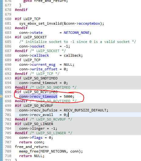

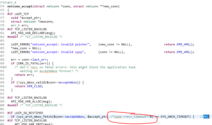

mpazzi
Hi Felipe,
thanks for your reply.
On my board I use RTOS, so I used TWRK65 with RTOS example and I have problem if I disconnect the cable, specially with PC as windows 10. The ping command work correctly in any situation.
For resolve the issue I have modify as down:
So I have introduced a timeout of 5sec on static err_t
netconn_recv_data(struct netconn *conn, void **new_buf), if I do not have communication for more then 5 sec the netconn is closed.
What do think about this solution ?
Marco
7,488 Views
FelipeGarcia
Hi Marco,
That looks correct from my side.
Felipe
