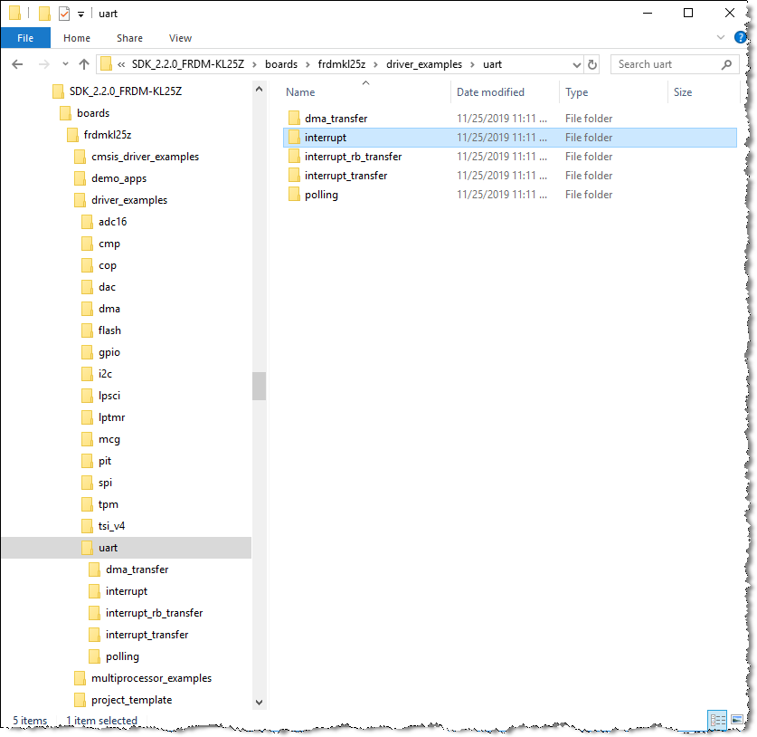

Hi Miguel,
Please download the latest MCUXpresso SDK of FRDM-KL25Z and refer the uart_interrupt example.
Robin
