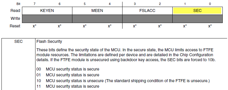

Hello panpwr:
The security or protection states do not prevent the application from using the Read Once command, but security could indeed prohibit the JLink from accessing those registers. Security depends on the value of the flash security byte (FSEC) loaded at flash address 0x040C, in particular the 2 least significant bits:
So you need to check your application or the binary to confirm what value is loaded to the address 0x040C in flash.
About the code:
- Make sure that the command is launched from RAM or from a different flash block other than 0, where the Program Once field is.
- Also your code does not seem to check if previous commands are finished (by checking CCIF flag) and clearing previous error flags (by writing 0x30 to FSTAT).
