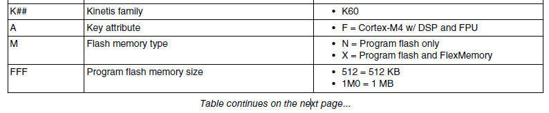

We would like to develop a hardware and software project based on uP MK60FX512VLQ12,
especially because it integrates EEPROM / FlexRam 16KB.
For this device the evaluation board  is TWR-K60F120M (see KINETISKMCUSELGD guide page 18 and page 24).
This card mounts MK60FN1M0VD12, in this uP is not present the 'EEPROM / FlexRam.
In the development system Kinetis Design Studio is not possible select TWR-K60F120M,
but we can create a project with the MK60FN1M0xxx12 device.
1) If we develop the project with Kinetis Design Studio with device MK60FN1M0xxx12
     we can transfer it and test it on the TWR-EVB K60F120M?
2) What do you suggest as an alternative to evaluate the MK60FX512VLQ12 before
   realize the hardware?

HI Paolo Ziveri
TWR-K60F120M uses MK60FN1M0VLQ12, and since you have a MK60FX512VLQ12, both of them have same features, with the differences of 'N/X' and '1M0/512' witch mean:
In KDS (Kinetis Design Studio) you should have to select MK60FX512xxx12, not MK60FN1M0xxx12
Hope this helps, please tell me if you have any more question on this.
