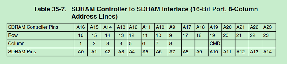

How should I go about hooking up the SDRAM addressing lines from the K66 to the Micron part MT48LC4M16A2B4-6A IT? I am having trouble figuring it out from the K66 RM. It is a 64Mb SDRAM module organized as 1Mb x 16 x 4 banks. There are 8 column addresses, with 12 address pins and 2 bank select pins. This doesn’t match any of the specific examples in the RM, and I’m not sure I understand it well enough to hook it up right. My best guess would be as follows:
SDRAM Controller Pins:
A9
A10
A11
A12
A13
A14
A15
A16
A17
A18
A19
A20
A21
A22
SDRAM Pins:
A7
A6
A5
A4
A3
A2
A1
A0
A8
A9
A10
A11
BA0
BA1
Is that accurate?”

Customer need to refer Table 35-7 about MT48LC4M16A2B4-6A SDRAM connection:
Customer connection is correct:
Wish it helps.
