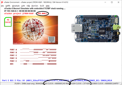

Use the uTasker open source project as reference - https://github.com/uTasker/uTasker-Kinetis select FRDM_K66F and enable USE_HIGH_SPEED_RUN_MODE and it will generate you a project that runs at full speed and its simulator will show you the details and allow you to step the code (in Visual Studio) to see all steps needed.
Also follow https://www.utasker.com/kinetis/MCG.html which gives some practical insights into the workings of the MCG.
Beware that the high speed run mode is required to operate at 180MHz and flash programming is not possible in this mode. Ether you need to switch clocks to <= 120MHz and move to RUN mode each time programming is required or else you need to generally use RUN mode (limited to 120MHz).

Simulation of the operation:
