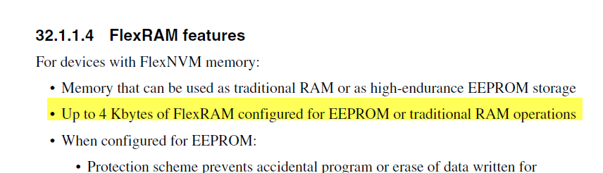

1. What is the maximum storage capacity of the EEPROM subsystem? As far as I understand it's the size of the FlexNVM which is 256KB.
    The maximum storage capacity of the eeprom is just the flexRAM size, it is 4KB, FlexNVM is just the eeprom backup memory, you don't need to care about it.
   Actually, the reference manual also mentioned it:
