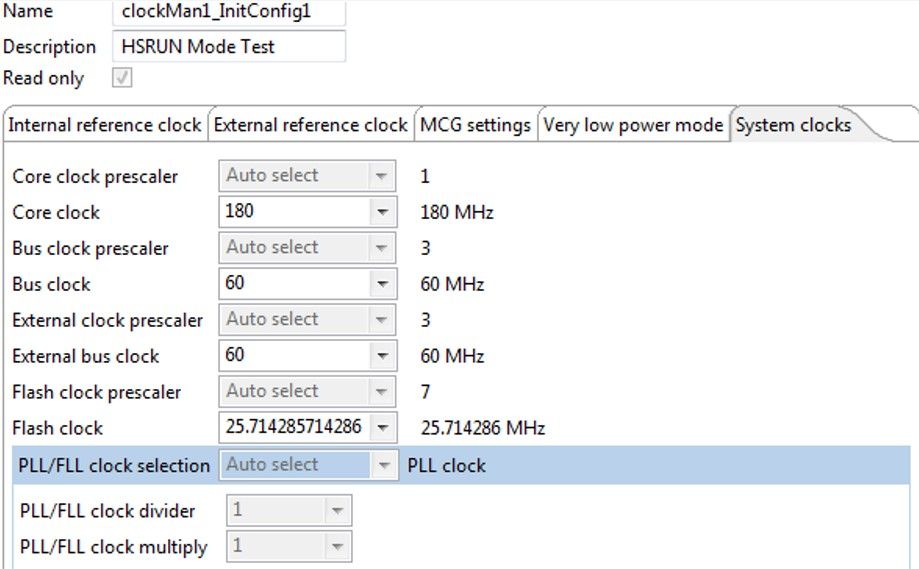

I am trying to get the K66 to run at 180MHz but it is not playing fair. I have also tried on the TWR-K65F180 board with the same problems.
I am using KDS3 PEx and KSDK1.3 to configure the clocks and running a project that it created. The code gets into SystemInit but the board resets when it switches to the PLL clock. If I select a PLL / system clock of 172MHz both my board and the TWR run fine but any higher and they fail.
I have configured all the other clocks in PEx to ensure they are in range for the requested clock.
The second issue is when the USB UTMI PHY PLL is enabled the code hangs waiting for the PLL to stabilise. I'm not sure if the two problems are related.
Is there a known problem with PEx generated clock initialisation code or the processors ability to run at 180MHz?

I do not know what is your configuration but here is a project for TWR-K65F180M board which is working in HSRUN mode at 180MHz, it is using PEx and KSDK 1.3. Remember to enable HSRUN mode in CPU component (In Allowed power modes section) and set System clocks as follows:
I am attaching it as reference. I am adding debug_Console component and using UART0 (which uses system clock as its source clock instead of using UART2 which is default console port but it is using bus clock) so you can corroborate that this is working at 180MHz (You can set a breakpoint at CLOCK_SYS_GetUartFreq function and validad freq value).

Thanks Mark and Isaac. Using your projects as a starting point it works. Changing back to my settings one-by-one I discovered the 180MHz issue was because I was setting the External bus speed to 20MHz. After some more searching I found something that said the maximum divider is 8. So for 180MHz the slowest External bus speed is 22.5MHz and that allows the clock setup to work.
The USB PHY PLL problem is also fixed by selecting the clock source as and External Crystal instead of an External Reference Clock even though my board is using a clock.
So I am now up and running with a basic setup.
