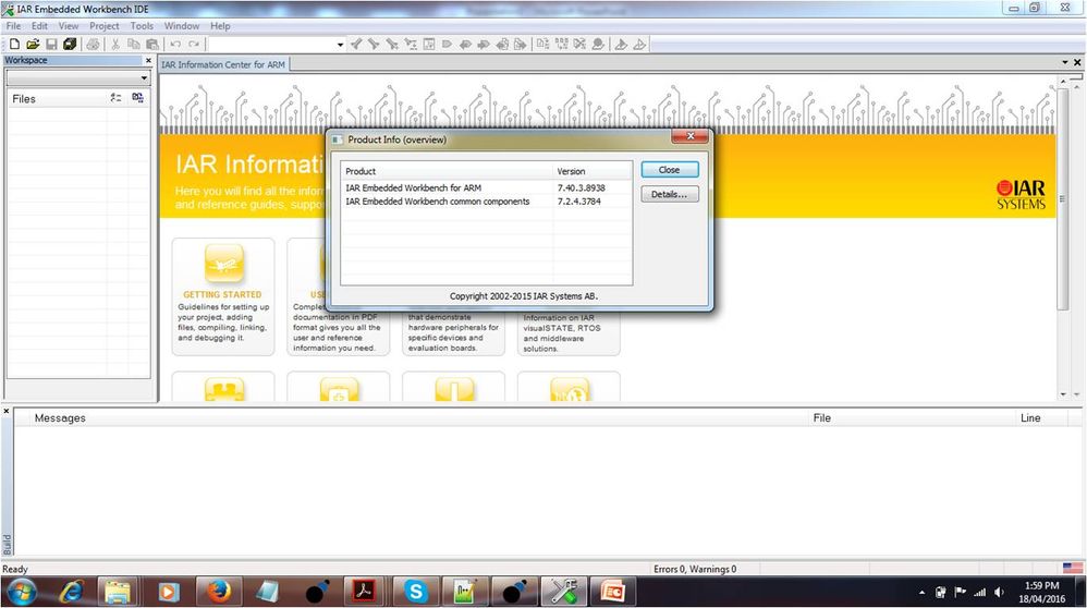

bhavinmaru
Hi Jingjing,
          Below I attach the screenshot of my IAR version please see that screenshot.previously there was no any issue with that version and it was working correctly.i am facing this problem just from 7-8 days.

kerryzhou
Hi Bhavin,
  My IAR version is 7.50, and when I run the code, eg:KINETIS_72MHz_SRC\KINETIS_72MHz_SRC\build\iar\hello_world
None error happens.
    Did you install two or more IAR version in your PC? If no, please try to uninstall or install your IAR again, and use the new project(download from my link) which never open your side.
