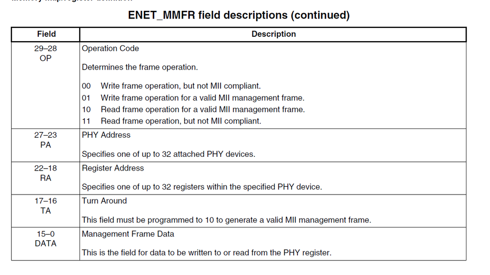

Now our project encountered a problem: the k64 cpu want to
communicate with micrel ksz8863 through SMI mode to visit the internal register
from 0~198. According to the SMI mode visit protocol, the different is below:
PAGE 1172 in attached k64 cpu
datasheet:
OP= 00 WRITE/OP=11 READ
And in 8863 datasheet (page33 ):
OP = 00 read/write function
It seems the two datasheet about
the OP is contradictory.
Do you have any guidance or
information according to your experience?

I have download the uTasker source code and checked the source code about the SMI mode, but the result is that the SMI mode in the source code used OP = 01/10,
So I think it is the MIIM mode not SMI mode indeed.
Now we want to use OP=00 to read/write internal register 0-198 from ksz8863.

In the code you need to search for the define PHY_MICREL_SMI.
For writes the code used is (MII_TA | MII_ST), instead of (MII_TA | MII_ST | WRITE_OP), as used for normal MIIM: fnMIIwrite().
For reads it is not possible to use the MIIM so you will find that the reads are performed by bit-banging the interface: fnMIIread().
In the solution the MIIM mode is used when the routines are passed an address != 0. When the address is 0, the SMI mode is used instead. Therefore you can certainly find this if you search.
