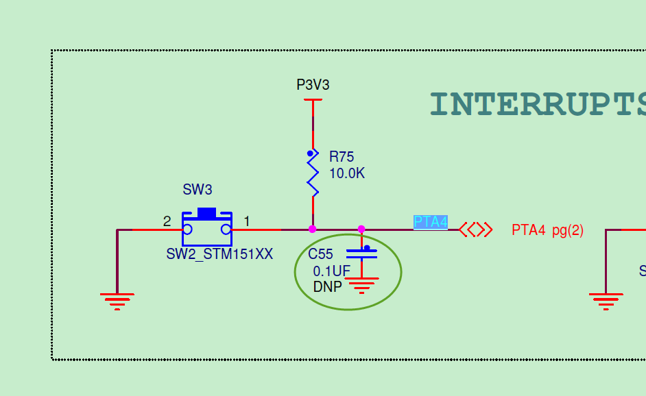

kerryzhou
Hi Wojciech Lesniewics,
    Do you use the FRDM-K64?
    If yes, please check the board, SW3, whether it have the capacitor on your PTA4 pin or not?
    Do you have C55 on your board? If your board have it, please remove this capacitor, then test it again.
Wish it helps you!
Kerry

wojciechlesniew
As I wrote, I'm using standard Freedom K64f board.
I'll remove this cap it in evening.
Should I also replace capacitor by reset button? Schematic says it's 1n and you've written, that it should be 100n.
6,945 Views

wojciechlesniew
Hi Kerry Zhou!
I checked my board and I don't have this capacitor soldered.
6,945 Views

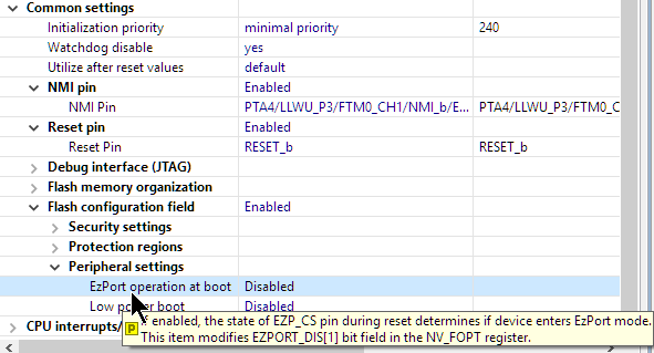

BlackNight
I had similar issues with the FRDM-K64F not booting/resetting properly. The problem I have identified is that it was because the EzPort was enabled by default. I had to disable it, and then booting worked fine.
If using Processor Expert, the setting is in the CPU component:
I hope this helps,
Erich

wojciechlesniew
Hi Erich, thank you for answer.
Disabling EzPort was the first thing I've done after I started using this board (about 01.2015). It didn't helped at all.
