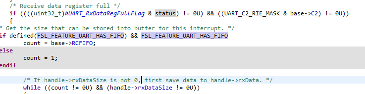

Hey guys,
I'm using the SDK's UART RX and TX Functions in order to send or receive data
UART_TransferReceiveNonBlocking()
and
UART_TransferSendNonBlocking()
The IRQ Callback sets a finnish Eventbit (or a failure eventbit).
So far for the theory :smileyhappy:
However there are some reasons where I end up in an infinite IRQ loop. From Debugging I found out that

Do you know How I could avoid this sittuation where kUART_RxDataRegFullFlag is full but count = 0? I looks like the SDK does not use the UART RX FIFO. To me that sounds like there is nothing in the RX register (or only garbage) but the interupt was triggerd.
How can i clear the kUART_RxDataRegFullFlag  Interrupt Pending flag?
Or, if it is not possible to clear the kUART_RxDataRegFullFlag  IRQ Pending flag, how can i shoot down the whole UARTX IRQ Vector.

I catched the case when the kUART_RxDataRegFullFlag is set but the FIFO is empty and added the handling which is the same as when receiving was successful or aborted.
    /* Receive data register full */
    if ((((uint32_t)kUART_RxDataRegFullFlag & status) != 0U) && ((UART_C2_RIE_MASK & base->C2) != 0U))
/* Get the size that can be stored into buffer for this interrupt. */
#if defined(FSL_FEATURE_UART_HAS_FIFO) && FSL_FEATURE_UART_HAS_FIFO
        count = base->RCFIFO;
#else
        count = 1;
#endif
        if( count == 0U && handle->rxDataSize > 0U ) {
           /* Disable and re-enable the global interrupt to protect the interrupt enable register during
             * read-modify-wrte. */
            irqMask = DisableGlobalIRQ();
            /* Disable RX interrupt/overrun interrupt/fram error/idle line detected interrupt */
            base->C2 &= ~((uint8_t)UART_C2_RIE_MASK | (uint8_t)UART_C2_ILIE_MASK);
            base->C3 &= ~((uint8_t)UART_C3_ORIE_MASK | (uint8_t)UART_C3_FEIE_MASK);
            /* Disable parity error interrupt when parity mode is enabled */
            if (((uint8_t)UART_C1_PE_MASK & base->C1) != 0U)
                base->C3 &= ~(uint8_t)UART_C3_PEIE_MASK;
            EnableGlobalIRQ(irqMask);
        /* If handle->rxDataSize is not 0, first save data to handle->rxData. */
        while ((count != 0U) && (handle->rxDataSize != 0U))
 This workaround brings back the driver to normal operation.  Anyway it would be good know from NXP, how this can be happen that the FIFO is empty but kUART_RxDataRegFullFlag is set.

The problem only arises in a single UART.
So at the moment I'm assuming there is some sort of hardware glitch.
Could it be that the UART RX Reg Data Full Interrupts is triggert by a rising flank (however the flank was only caused by some sort of glitch). No Start/Stop Bits where detected. Therefore there is no data in the RX FIFO.
@Sabina. If this assumption is correct what would be the proper way to handle this?

I also found the same behaviour. When data is recieving and if we call UART_TransferReceiveNonBlocking, we are getting such error. I also see many time HW Buffer OverFlow. I am also using UART RTOS example and just update the uart rtso driver with timeout (in default, code is blocking infinite).
7,042 Views

Hello Julian,
I've been trying to reproduce this but have not been successful. Is it possible for you to recreate this using to FRDMs one master and one slave so that I can reproduce it from my end and check it with detail and be able to test it myself.
I understand what you are doing, however its difficult to follow with code only.
