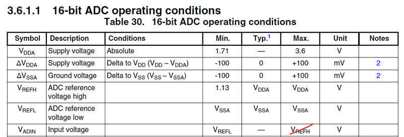

troelsoesteraa
Not sure if it is relevant, but I believe the ADC16 is much the same implementation across all Kinetis devices. One thing that is different in the data sheet for MK22FN256VLL12 is that input range, Vadin is VREFL to 31/32 * VREFH when operating in 16-bit differential modes, and VREFL to VREFH in other modes. Also, no specifications for full scale error in more than 12 bit range.
Would it be possible for you try try single-ended mode to see if this improves linearity in the upper range?

I went ahead and configured the ADC for SE measurement. This does appear to fix the linearity issue and extends the usable range all the way to VREFH.
I believe the K64 Data Sheet should be updated to state that the usable range for differential measurements is reduced to 31/32*VREFH (or whatever the appropriate fraction is. Not sure where 31/32 comes from, since the ADC is 16-bit).

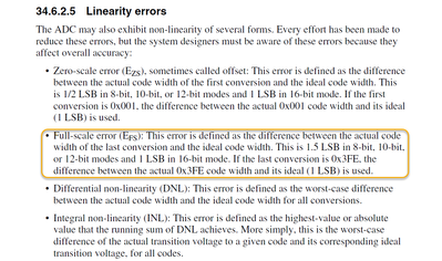

After double checking your issue on what you are trying to understand, I think you are wrong when you say "The ADC specification suggests about 6 LSBs of full-scale error (or 0.02% error).", because checking the Reference Manual you can see the following:
Based on this, you will need to consider that the difference between your conversion code width when you have maximum voltage (measured 3.296V) and the ideal code width (1 LSB = 3.3V) is the one that is going to be used, and that's why you see 32133 as your maximum code.

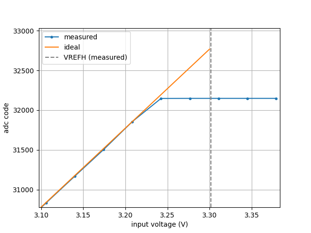

I'm sorry, I don't follow either the language of the manual or your explanation. Full-scale error is typically defined as the overall error between an ideal ADC response and the actual ADC response when the input voltage is at its maximum.
Below is another measured ADC transfer function (on a different unit, but which shows the same qualitative behavior). Now I am plotting the x-axis in units of V, and I provide the measured value of VREFH as a dashed line for reference (VREFH = 3.3015 V in this example, and is the same as VDDA).
You can see that the ADC output code hits a limit of 32148 when the input reaches 3.24 V, or 98% of the full-scale range. The ideal ADC code is shown in orange, reaching (2^15 - 1) at input = VREFH. This corresponds to a full-scale error (by my understanding) of 32767 - 32148 = 619 LSBs.
