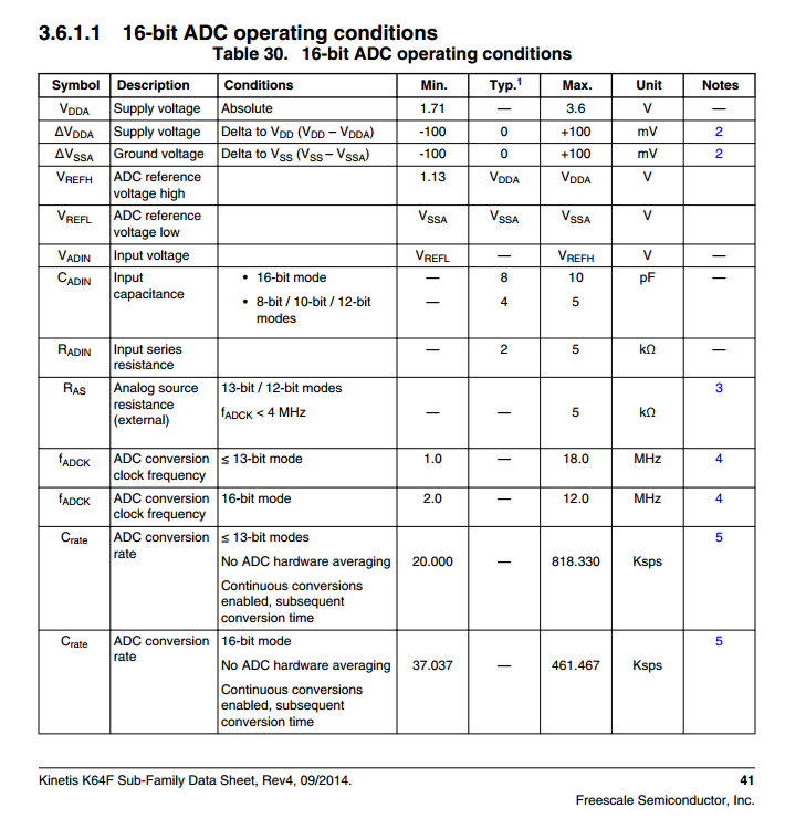

In the K64F datasheet, it is specified that:
Max VREFH = VDDA.
(See figure 3.6.1.1)
In our application, VREFH is connected to an external 3.3V voltage reference IC (LM4120AIM5-3.3), and VDDA is supplied by a separate 3.3V power supply IC (MAX8881EUT33-T). What are the repercussions in situations where VDDA is lower than VREFH(due to the fluctuations in line regulation of both chips)?

it is mentioned in the datasheet specification, that the difference between VREFH and VDDA can be max 100mV (Table 30). Each pins is protected by pair of clamping diodes. If the difference VREFH - VDDA > 100mV the current starts to flow through the clamping diode to VDDA line. The diodes are usually designed for currents from 2 to 10mA max. The repercussion of this could be VDDA out of range or damaged clamping diode.
The measurement range is defined by VREFL to VREFH. Usually VREFL = VSS. Then VREFH is divided by 12/16 bit. The measured value has to be in this range, otherwise the values higher than VREFH will be measured as max (0x0FFF or 0xFFFF).
The use of two separated power supplies for VDDA and VREFH is dangerous. It is not maintained right voltage level on those pins during switch ON and OFF process. So the best way is to use one DC power source for VREFH and VDDA. VREFH has to be connected by low pass filter - small inductance with dedicated blocking capacitor to avoid noise on VREFH pin.

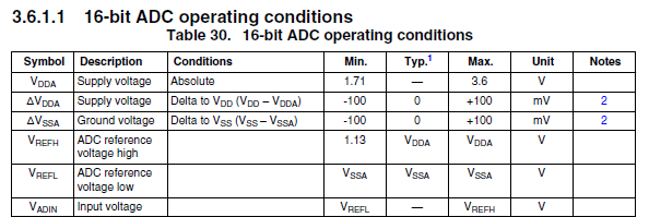

This is a misleading response. Table 30 (reproduced below) shows that VDDA (analog supply voltage) must remain within ±100 mV of VDD (supply voltage). It then states that VREFH has a maximum set by VDDA. So, would it instead be possible to supply both VREFH and VDDA from a precision voltage reference (3.3 V, 20 mA, ±0.1% accuracy, 50 ppm/°C) while VDD is supplied by a separate voltage regulator (3.3 V, 1 A, 1% accuracy). This would result in a worst-case mismatch of about 1.1%, or VDDA = VDD + 36 mV, while preserving a precision ADC reference voltage.

Thank you for the replies. Just to clarify, in our application, VREFH and VDDA are both 3.3V, but in the worst case scenario, VREFH could be 20 mV greater than VDDA due to line regulation specs of both ICs. What specifically are the repercussions in this scenario? miduo​ has mentioned that this will not damage the MCU but will cause the ADC conversion to be incorrect. Could you please describe this in further detail? (i.e. whether it is the case where the top bits are unusable, or whether the entire span is unusable). Thank you for your responses.

Please don't use the VREFH > VDDA ! The max level for VREFH is VDDA even if the VDDA is lower than 3.3V. See section 3.6.1.1 in previous message.

miduo
There will have no problem that the VREFH is over the VDDA, it will have no damage to MCU itself, but the issue is it will led ADC convert value incorrect.
