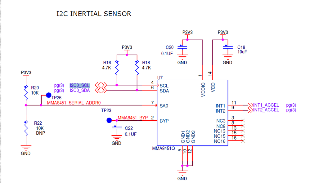

Hello, i am working on a custom board using k64 and i have just accesed it via jtag,tested some basic pin I/O and it's ok.
I now have a problem accessing the MMA8451Q over I2C .
I have used the electrical schematic as advised in it's datasheet (SA0 is pulled down via 10k resistor). On the microcontroller side i am using PTE0 (I2C1_SDA) and PTE1(I2C1_SCL) both with 2k2 pull up resistors.
I have tried using the example from the sdk :  cmsis_i2c_read_accel_value_transfer .
I  have replaced the pins and port used in the example with my own and the console says that it is not able to find and accelerometer device.
I have also tried to modify the macro on line 22 into pointing to Driver_I2C1 instead of Driver_I2C0 and in the rest of the file into I2C1 but it gives compilation errors.
Any thoughts ?

Hi Bogdan Nica,
   1. check the MMA8451Q schematic:
Of course you can connect SA0 =0.
Just the slave address is different:
About the code, if you can connect the PTE24 and PTE25, then you can test it with the SDK code directly, without modification, just test whether your hardware have problems or not.
But if you can't modify your hardware, then you need to modify the code pin to PTE0 and PTE1, the I2C interface you need to modify it to I2C1.
If you still have problems, you can check the I2C bus, whether it has wave or not? If the SCK and SDA pin even don't have the wave, it means your code still have problems.
Please try it on your side at first.
Kerry

bogdan_adrian91
kerryzhou‌
Thank you for the help ,
It ended up being the code .
I used another example that i modified and is now accessing the accelerometer.
Thank a lot !
