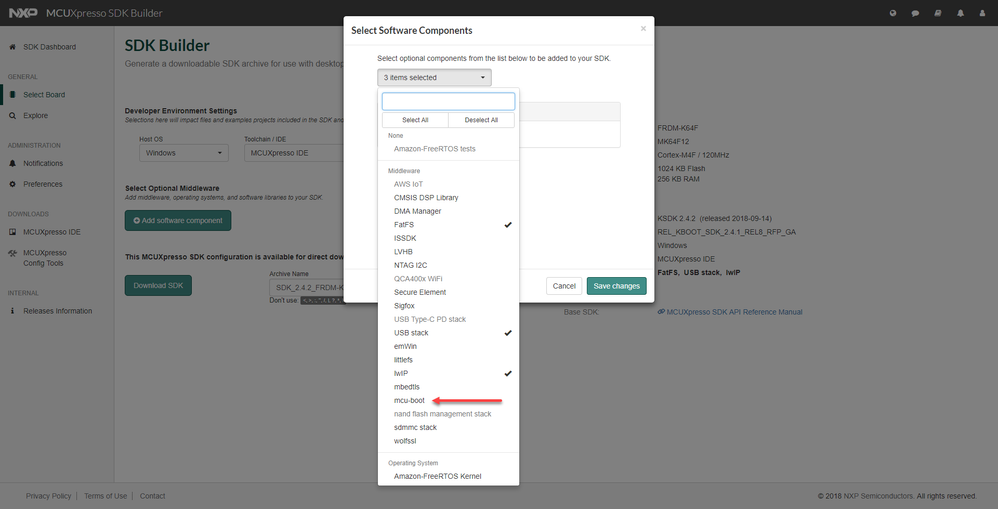

victorjimenez
Hello Léo,
The new version of the SDK is out now. When you download it please select mcu-boot in the section Add software component.
Victor.
