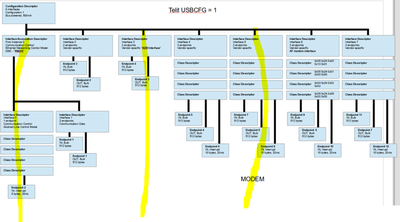

And following is the Telit's USB configuration, whereby the interfaces of interest are the modem (for AT command control), its Network interface (in this case it uses RNDIS class) and an Android Debug Bridge (in all it has 8 interfaces but the others are not needed, and ADB is optional).
I would recommend using a K66 if you need to use Kinetis since its HS USB is much better suited to such work. The FS USB host in the K64 is not a full USB host implementation (and has limited endpoints) and so it restricted (it will work, but it is slower and needs more overhead to work out the HS USB host limitations in FW).
For HS USB and networking the i.MX RT parts are recommended (the uTasker solution works on any Kinetis or i.MX RT with no effort to move between the two families). The i.MX RT parts are easier to find and better priced that Kinetis nowadays and offer much improved performance.
